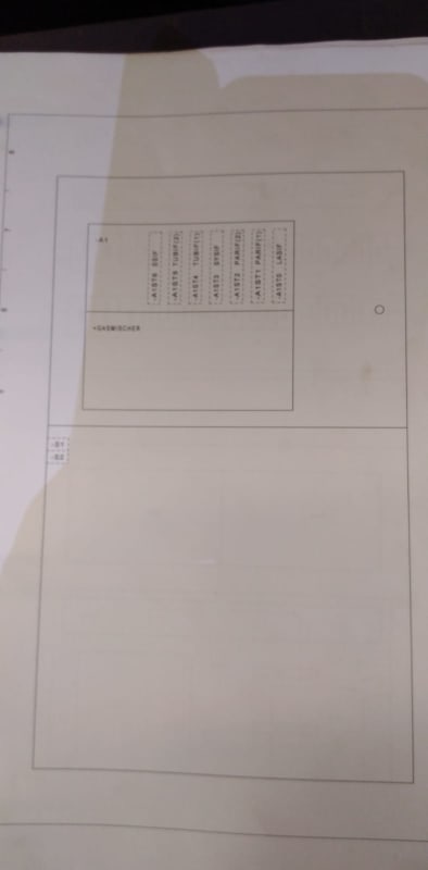

OK first step is to run a program while the operating mode on the cnc from mmc/ssi to number 1 mmc
while the program is running, see if output number 1 in the cnc comes on when you would expect the shutter to open. If it does, run a wire from this output to terminal block XW4A, terminal number 2, in the BTL/laser cabinet. that should get your shutter to work.
As for error- run a wire from terminal block XW4A, terminal number 3, in the BTL/laser cabinet to input number 5 in the cnc cabinet. your inputs in the cnc will be either in a black box w 2 vertical rows of LED or a rack with red and white input modules in it. if the later, you may be missing the needed modules, just take one from something that's not used.
Many of these were converted from MMC-SSI to straight MMC because of problems.

Good afternoon, Mr. Krug. Today I looked at the CNC cabinet, and did not understand what exactly is the input module. I photographed what I guess it is. If this is the module, then on the first point about SHUTTER, I have to look at output one if it is indicated. Therefore, I have to run a cable from BTL cabinet / XW4A / to input number 5 of the same input-output module of CNC cabinet.
