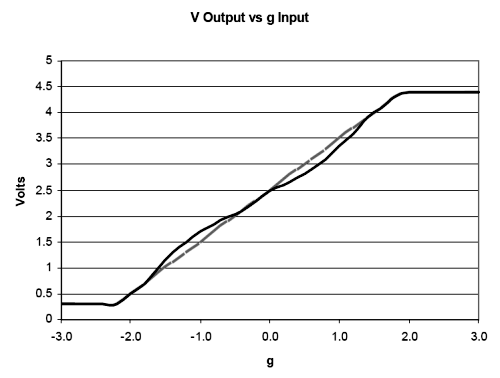

Volts vs acceleration will be specific to your device. Output of a 3G accelerometer for a 5V circuit will be different from 10G accelerometers or those that might use a 4-20 mA current as an output signal.
I think you need a conversion chart from the makers of the device showing output voltage and the corresponding acceleration of the device, like the grey line in this one.
This may be typical of similar devices as yours, but I do not know.
A chart like this should be included in the tech info somewhere in the box, or contact the device mfgr.

In the above chart, 0 g means the object is not moving? or the object is moving at constant velocity? What does actually the 0 g represents?
That it is not accelerating or decelerating. Its velocity vector remains constant. Moving at a constant speed in always the same direction, or completely at rest (velocity vector =0).

the chart that you have mentioned above is the relation of voltage with g. Is this relationship valid only if the acceleration in g's and voltage in volts?
or if the voltage is in mv or if the acceleration is in m/s2, how do i need to change it?
If i get the acceleration values(in g's) corresponding to the voltage values (from the manufacturer, like the one in the graph), do i need to do any other conversion? Like, conversion with the voltage value of zero g or something?
Or just the acceleration values corresponding to the measured voltage directly from the chart is the answer?
If you have the chart above for your device,
Start at voltage 4V
Draw horizontal line to the sloped line
Draw vertical line down to g = 1.6
That's acceleration in terms of number of earth gravity's.
g at the Earth's surface is 32.174 ft per second squared, so
Acceleration of the device in ft/sec^2 would be 1.6 g x 32.174 ft/sec^2 = 51.478 ft/sec^2

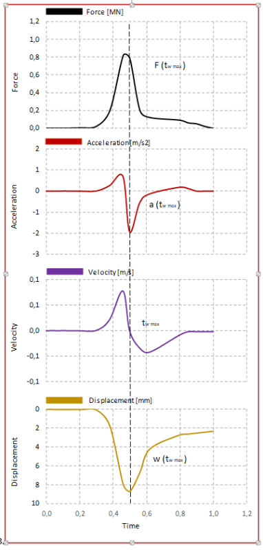

I need to calculate the velocity from the acceleration values and thereby displacement based on the below graph. It is for the Rapid load test.
[URL unfurl="true"]https://res.cloudinary.com/engineering-com/raw/upload/v1664887773/tips/Diagrams_1_h8ucdc.docx[/url]
And i am unable to generate an acceleration graph like the one in the attachement. Could you please help?

If you begin with an acceleration curve, the area below the curve between any two times is the change in velocity during that time. You can then construct the velocity curve. Likewise, the area below the velocity curve will be the change in distance moved.
If you know the mass of the object that the acceleramometer is attached to, the force curve can be calculated. F = mass * velocity.
I think you might be able to assume that your device has the same output voltage to acceleration as the graph I found. I would assume that it does and run some tests on an object of known mass to verify that assumption.
