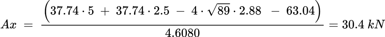

Sorry, here is the equation with units:
To clarify, the main diagonal structure is fixed at the apex. The tie beam is pinned. Also, because of symmetry I am only considering one side in the calculation. The load on the frame is 4kN/m.
The upwards force is the vertical reaction at the pin of the tie beam.
The moment of 63.04 kNm is the moment at the joint where the tie beam connects to the main diagonal frame.
This is calculated by:
Theta = 57.99 deg and where x = 4m (distance from support to joint intersection) gives at moment of 63.04 kNm.
Like I said before if the tie beam is fixed to the main frame I can take moments about the apex and find the axial force in the tie beam (anti-clockwise as positive)
The model in SAP2000 gives 21.19 kN. So we are basically there.
So, the question is: what do you do differently if the tie beam is pinned under the same loading? Being pinned the axial force increases. The answer from the software is 28.5 kN. My calculations has given me an axial force of 30.4 kN.
