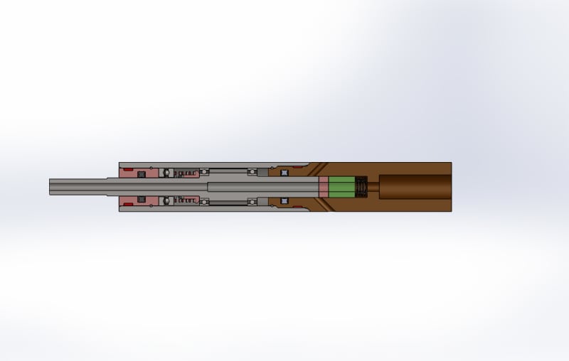

Hi.. 1st time posting here and not an engineer by trade so I appreciate any help/guidance and will do my best to be clear.
I have designed a small water rotational swivel. It is essentially a housing with a shaft through it. The shaft has 2 radial bearings on it. The housing is sealed on both ends. The inlet side of the swivel is larger than the outlet side on the OD of the shaft.
I intend to have the housing filled with hydraulic oil (type not yet determined) prior to being sealed.
During operation, the shaft inside will move forward because of the force of the water, with the smaller OD exiting the housing seal and more of the larger inlet side entering the housing. This should increase oil pressure, acting like a piston compressing the oil. Maybe I'm wrong about that?

This needs a drawing, or sketch as it's too difficult to work out from a written description.
But from what I can gather if your internal sealed oil volume is decreasing the increase in pressure you can calculate using the Bulk Modulus of your oil assuming you have 100% oil in the void.
It won't take much of a volume change to get a huge pressure change.
Mineral oil is about 2.5 x 10^5 psi BM. in other words to get say a pressure increase of 1000 psi your volume would only need to change by 1000 / 2.5 10^5 = 0.4%
This assumes your housing doesn't expand, which is quite a big assumption. Any air or gas in the housing will change things hugely.
yes forces will eventually balance but depends on the amount of volume change.
Hi. Thanks for the basic information. I've attached a section view of the model as it sits now.
The water will enter through the brown adapter on the right hand side. It should generate no more than 400 lbs of axial thrust on the shaft/disc/seal combo. The radial bearings are a slip fit to be able to move when presented with an axial load. The hope of the design is that the increased area of the inlet side of the shaft moving in to the housing due to water thrust will increase internal oil pressure due to increased volume in the housing. Again, am hoping that the oil pressure will reach or find "neutral" around 400 PSI internally and will allow this device to swivel with quite a bit less friction than it would with no oil pressure.
The left side of the shaft (longest journal) is approximately .188" OD while the right side journal is approx .218" OD, so .030" larger. The shaft is designed to move forward due to thrust a maximum of .125"

Yes, there is an equation.
The basic equation is
Code:
ΔP = β*ΔV/V+P0
Where:
ΔP is the change in pressure
β is the bulk modulus of oil
ΔV is the volume the oil is compress
V is the volume of oil under compression
P0 is the initial pressure.
This simple formula doesn't address how far the shaft will move because it will see an opposing force and be not move as far as you think.
A good model for this would assume that a force is applied to the shaft. The shaft starts to move compressing the oil. As the oil pressure increase it opposes the force that is being applied to the shaft. Eventually an equilibrium of forces will be found and there will be no motion but before that the shaft may go a little beyond the equilibrium state. The simple equation above does not compute ΔV.
So what is the nature of the force on the shaft?
Peter Nachtwey
Delta Computer Systems
The delta V will be the product of the area difference between the two shaft cross sections multiplied by the delta shaft movment.
Ted
But how far will the shaft movement be? That depends on the force and opposing force. The shaft will move until there is an equilibrium. This is why we need to know about the force that is moving the shaft. You can see that there is also a P0 or initial pressure term.

Thanks to everyone that has chimed in. I really appreciate the feedback and help.
The pressure on that shaft driving forward should be approximately 400 lbs of axial load, caused by the high pressure water hitting the exposed area of the shaft/seal. 40,000 PSI of water pressure and an exposed area of 0.01sq2
The problem we're really faced with is that this design is very, very small... 13MM OD on the housing. The thrust bearing is only rated to around 215 lbs of force and due to size constraints, there's nothing else available that will allow for more axial load.
The hope is to offset some of the axial load of the shaft by creating a hydrodynamic bearing effect in conjunction with the trust bearing in the oil housing chamber due to increased oil volume.
