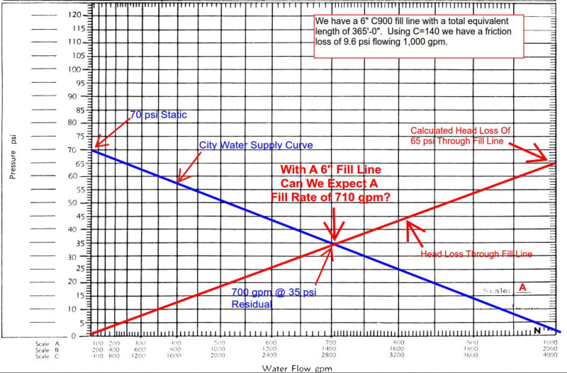

I have a storage facility that requires 1,704 gpm for 60 minutes.
City water supply is 70 psi static, 35 psi residual flowing 700 gpm.
It's obvious I will need a tank and fire pump but what size tank? The easy answer is 1,704*60=102,240 gallons.
With steel tanks running $1.50 or more a gallon I would like to use an automatic fill valve so I can install a smaller tank.
Let's look at the CLA-VAL Model 100-01 automatic fill valve.
[URL unfurl="true"]https://www.cla-valpacific.com/documents/pdf/E-100-01.pdf[/url]
I want to install a 4” C900 4” fill line which has a total equivalent length of 325' which, when using C=140, will give us a friction loss of 49.7 psi when flowing 1,000 gpm.
I know, NFPA tells C=150 for C900 but I want to error on the side of caution so I'll use 140.
When the tank is full the water level is 30'-0” so I need to add another 30*.433=13.0 psi to the 49.7 psi which brings me to 62.7 psi. Using the Model 100-01 Flow Chart it appears the pressure drop through the valve will be 18 psi flowing 1,000 gpm so I have to add that 18 psi to the 62.7 psi giving us a total loss of 80.7 psi so just to be on the safe side let's call it 85 psi @ 1,000 gpm just to be a little more on the safe side.
I am going to graph this on the ^1.85 graph paper
Do you agree that I could expect an automatic fill rate of 650 gpm when the tank is full or am I all wet?
At an automatic fill rate of 650 gpm I can reduce the size of the tank to from 102,240 gallons by 650*60=39,000 gallons to 63,240 gallons? Would I be safe with a 65,000 gallon tank?

OK
Joys of reading it on a phone but I can see what you're planning to do.
I would still want a historical log over several days of the static water pressure to be able to demonstrate what the actual min pressure is at any time and if I was the person approving this I would want the same.
I agree there is no max velocity, but there is economic one and that is more like 2- 3 m/sec.
Also if this is a potable water supply, I think the water company might make you flow in at the top of the tank with an air gap or insert two flow non return valves which add to your pressure drop. Also what is the maximum they will let you take? I can't imagine they would be too happy with you flattening their system.
but 650 ignores the static head. Your redline needs to start at 13psi at 0 flow rate so the intersection is closer to 600GPM
But try a 6" pipe and see how much more flow you can get for not a lot more cost in pipe. This may or may not be smaller increase than the decrease in your tank size. Do the maths. Maybe not worth it.
Anyway it's the AHJ you need to persuade - Have you asked them?
LittleInch,
Not a huge difference between 4" and 6" but here is what I came up with.
We have a 6" C900 fill line with a total equivalent length of 365'-0". Using C=140 we have a friction loss of 9.6 psi flowing 1,000 gpm.
As before when the tank is full the water level is 30'-0” so I need to add another 30*.433=13.0 psi to the 9.6 psi which brings me to 22.6 psi. Using the Model 100-01 Flow Chart it appears the pressure drop through the valve will be 18 psi flowing 1,000 gpm so I have to add that 18 psi to the 22.6 psi giving us a total loss of 40.6 psi so just to be on the safe side let's call it 65 psi @ 1,000 gpm just to be a little more on the safe side.
Not as much of an increase as some might expect. 55 gpm more but when you look at the steep water supply graph it shouldn't surprising.

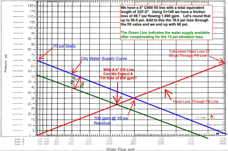

LittleInch,
Duh, I don't know how I missed the workings of the 13 psi elevation loss because I do it all the time changing elevation between source and fire pump suction.
I think this is a more accurate presentation of the 4" fill line. I am using 4" just because it makes my curve steeper.
So if the tank is near full I can expect a fill rate of 630 gpm but as the tank leveled is lowered, say half where the elevation loss is but 6.5 psi, I can expect a higher fill rate. Somewhere around 670 gpm perhaps?

I kind of understand what you've done, but I don't think it is correct.
Your supply line (the water main) Blue line is correct. Don't change it.
Your demand line or system curve is not correct. This assumes that the elevation of the water line connection point is at the start of your 325' pipe, your pipe is flat and the static head comes from the head of water in the tank?? This isn't the same as having the elevation of the water line at a different level to the suction of the fire pump - that's something different.
It needs to stat at 0GPM with 13psi because if you don't have 13 psi you won't get any flow. Then at 1000 gpm you should be at your 85 psi pressure which also includes the static head, pipe frictional losses and the loss through the valve.
Then intersection is about 620. Ok, not much difference but it is the correct way of doing it.
Your 6" line on the other hand is about 750 gpm (start 13 psi, end at 45 psi).
LittleInch,
The water level in the tank is 30' above the source which is the 13 psi, or green line, I inserted below the blue line. I figure this takes care of any elevation differences.
