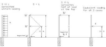

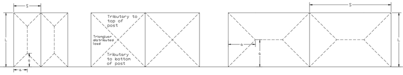

Thanks for the more detailed explanations, just what does this S represent exactly (S<<L, S=L, S>>L)?
And, if I understood correctly:
If several different forces act on the post (and not only an equally distributed load, but e.g. wind and some concentrated forces, and e.g. wind on the cameras at the top of the post, etc.) and all these forces create a moment M (marked blue in the picture below), the height h that we take in the formula will be that h (circled orange) which, when multiplied by the resultant of all the forces R (marked red) acting on the post, gives the same moment M.
While it is simpler with the fence, i.e. if it is loaded only by the distributed load from the wind w that create moment Mw, the distance of the force resultant Rw will be hw=H/2 (H=height of the fence), and also that resultant create the same moment Mw (Rw*hw = Mw).
So that in both cases the h that enters the formula
is the one that, when multiplied by the resultant force, gives the moment at the bottom of the post/fence, and force P in the second formula is actually resultant force that creates the same moment.
That is an older sketch with variable names that never got updated to match the current design guide. It's showing S as the post spacing and L as the post height and no gap at the bottom of the fencing.
For flexible fencing like chain link, if the post spacing is much smaller than the post height, the loading approaches a distributed load.
If the post spacing is equal to the height, you get concentrated loads at the top and bottom from rails or wires, and distributed triangular load from the mesh that simplifies to a point load at the mid-height.
If the post spacing is much more than the post height, the loading approaches concentrated loads, half at the top and half at the bottom. All 3 of these load cases produce a moment at the bottom of the post equivalent to a point load at the mid height. Mid rails change the distribution but the end result is equivalent.
In ASCE 7, the wind forces don't increase with height until after you pass 15' above grade, but yes, if you have forces acting at multiple heights, sum the resulting moments, divide by the sum of the forces and you'll get the IBC application height, h to use in the IBC formula in place of the (1/2 h) that I'm showing in the design guide. P would be the sum of the forces.
