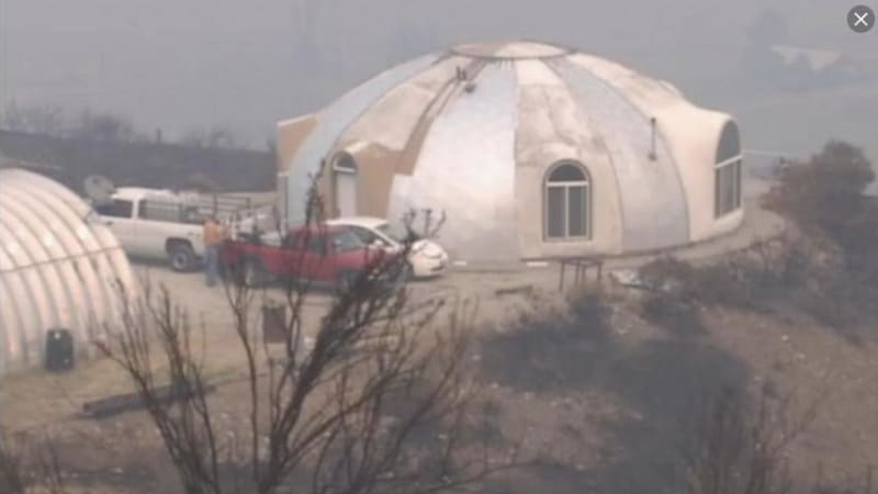

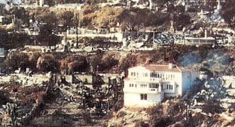

You can build houses that won't burn. That's what should be done. They may look a bit different but that's just the requirement for living in that kind of space. There's a standard for making or building fireproof (from external causes) houses. I think they should should be a bit more radical than the "Fire Resistant" requirements and make them fire proof. That way everyone can shelter-in-place while not fleeing into the unknown of the roads during a catastrophe.
These three houses were the only ones in the area built with ICF tech.
This house was also ICF with the exception of the garage that in a subsequent fire burnt to the ground but it left the house undamaged. That's a wood structure against the house that couldn't even burn the house!!
Same goes for hurricanes. You can build hurricane proof houses and they all should be.
