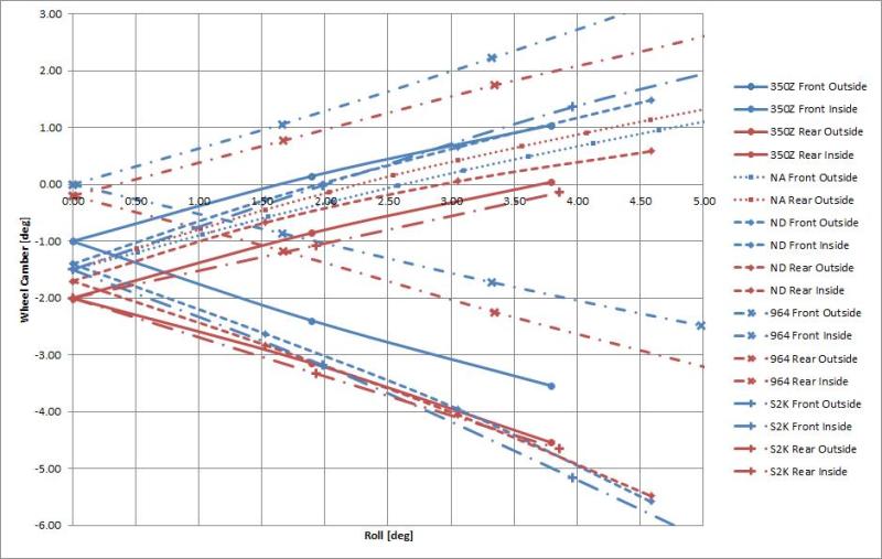

Inspired by cibachrome's posts I decided to do some digging and number crunching myself. The data is from five "sporty" RWD cars whose camber curves I could find on the internet. They are the Nissan 350Z, the NA (1989-1997) Mazda Miata, the ND (2015-) Mazda Miata, the 964 (1989-1994) Porsche 911 and the Honda S2000.
I started with the camber curves (camber w.r.t car vs. suspension travel) and using the front and rear track widths of the respective cars I converted that into camber w.r.t road vs. roll angle:

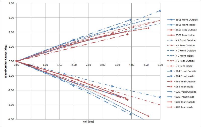

To me, the slopes of all the traces look quite similar, so I decided to plot camber change vs. roll angle, essentially taking the above graph and vertically shifting the traces to start at 0:

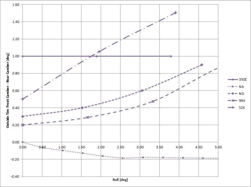

From this graph, it does seem that all the slopes are in the same ballpark. Also, it's clear that that the front outside wheels are reaching positive camber faster than the rear outside wheels, which seems to correlate with the idea of the front end letting go before the rear. With this in mind, I made another plot, this time of the front outside wheel camber minus the rear outside wheel camber vs. roll angle to see how in these vehicles "front positive camber margin" changes with roll:
The Z is relatively constant with roll whereas the others seem to be more progressive.
I realize that for the NA Miata I probably have the wrong static camber numbers which is why it seems to be an outlier, so I guess we can ignore those curves...
