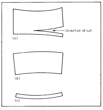

For any steel fabricators out there,
I'm doing a steel girder truss with a WT section at the top and bottom chord and double angles making the webs. I would like to camber the truss (it's not a transfer beam element) and I was trying to work out how they would do it in the shop. The way I was picturing it was to take say a W24x176, camber it and then cut in half to make 2 WT12x88 sections with equivalent camber (I know cambering can be more of an art than a science). I could be totally wrong on this so if you all have any input that would be appreciated.

retired13, look at the video again - that camber machine isn't going to play nice with the stem of a WT. Maybe you could camber a WT but you'd have to leave some full depth beam at each end.
When you cut a W into a WT, or any steel for that matter, you get distortion. See image below. The cut edge expands due to the heat and is restrained when it cools. This will work with the camber on the bottom chord and against the camber on the top. So the camber of the top and bottom chord might not match exactly, but that might not matter. I assume this is all welded with bolted splices if/as needed?
