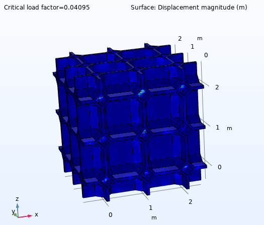

I perform a linear buckling analysis for two similar geometries, where one model has thickness t = 0.01 m, and the other has thickness t = 0.035 m. Otherwise everything is exactly the same. The thinner model (t = 0.01m) however gives me a higher critical buckling load compared to thicker model (t = 0.035m)- could this be right? The slope in the linear region or Young's Modulus for both models seem to correspond well with previous studies, it is just that I'm getting lower buckling load as I increase the thickness.
Edit: I had to increase the Dimensions of the Krylov space from 0 to 300 to capture any buckling modes for the t = 0.035 m model.

What do the buckling mode shapes look like for the 0.035 model? I can't see the deformed shape in your screen grab.
What loading have you applied - edge load, edge pressure, enforced displacement, or what? If you have used enforced displacement, the loads generated will be much higher for the thicker model, for the same displacement.
I have used a displacement of -0.01m in the x-direction. Mode shape looks like this:
Sigh. If you are applying the same enforced displacement to both models, the applied load on the thicker part will be much higher, hence the lower predicted eigenvalue.

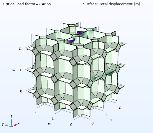

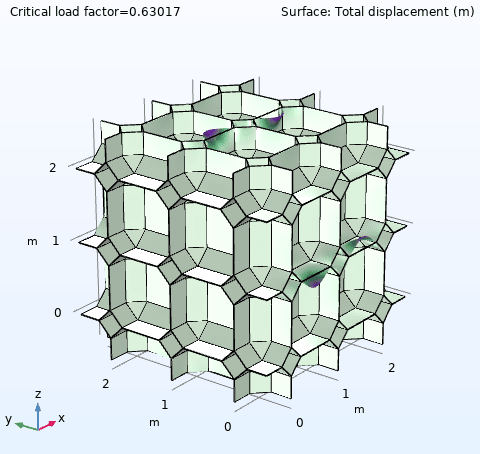

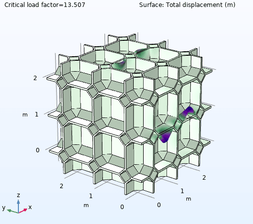

I get what you are saying, but here is why I am confused:
Here are three seperate models with thickness of t = 0.005m, 0.01m and 0.025m respectively, all have a displacement of -0.01m in the x-direction. As you can see the critical buckling load increases alongside the thickness.
t= 0.005 m
t= 0.010 m
t= 0.025 m
But then suddenly at thickness t=0.035m the buckling mode drops all the way to 0.04095?

I think there is a degeneration to the geometry. Make the thickness 0.1mm to check what it looks like.
Also, create a section through the part to show a representative sample of the hidden nodes where the problem exists, maybe with some more pixels to actually see what is happening.
so 0.005, 0.01, 0.025 trend as expected, and show the same mode.
but 0.035 bucks this trend and has a different mode shape ...
