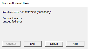

I want to know the macro which can measure length of curve selected by user.basically i want to create multipoints on curve for which i need length of curve.
i have tried this code for measuring the length... but error 91 is coming.... please help.
Dim SpaWorkbench As SpaWorkbench
Dim theMeasurable As Measurable
Set theMeasurable = SpaWorkbench.GetMeasurable(oCurve)
MsgBox theMeasurable.Length
Code:
set SpaWorkbench = partDocument1.GetWorkbench("SPAWorkbench")
set theMeasurable = spaWorkbench.GetMeasurable(part1.CreateReferenceFromObject(oCurve))
Thanks code is working...But how to check the length, how to print.
when i use :
Msgbox theMeasurable.Length
it shows error 440.
again error.

in my cat part i simply making curve and point on curve and than run this code.
Try selecting curve in specification tree. When you select it from a 3D-spapce it's edge gets selected instead.
Edge itself is a reference so you don't need to call CreateReferenceFromObject() for it.
