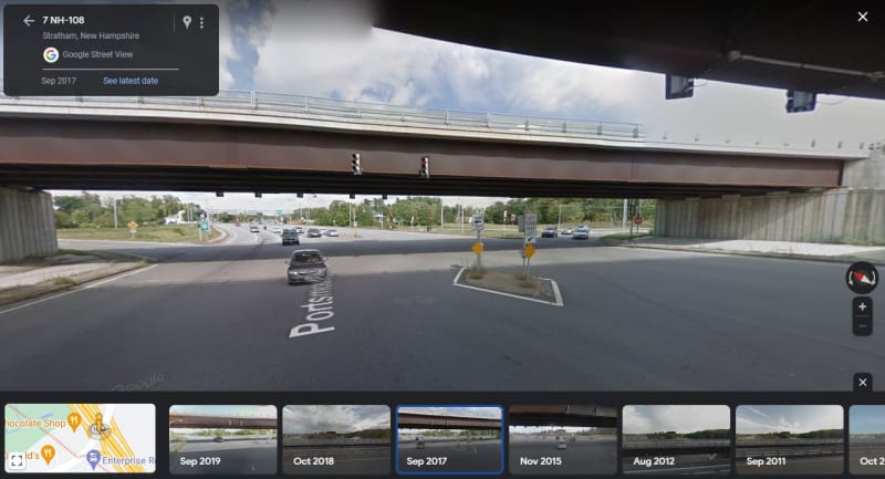

Can anyone explain why these steel highway girders have this uniform deformed-like appearance?
Mylzie
Aug 19, 2021
5
I drive under this on my way to work every day and have always been curious about it. My boss told me, at the time this bridge was built, these were the deepest wide-flange girders in the world (or maybe it was just the U.S.?). At first, I thought it was just the bridge above me casting a wavy shadow, but all 4 girders appear like this.
The lighter portions look like a uniform \/\/\/\/\/\/\/\/\/\/\/\/ strain. My guess is the darker and lighter portions of the flange are deflecting outward opposite of one another. Is this a defect from the fabrication process? Flange local-buckling E: web buckling? Just spit balling at this point.
Located in NH by the way.
Here's a thought, could the V's be a cast shadow from the adjacent bridge rail?
I've also seen something similar on plate girders, not V's but straight lines, where diaphragm connection plates are welded to the opposite side.

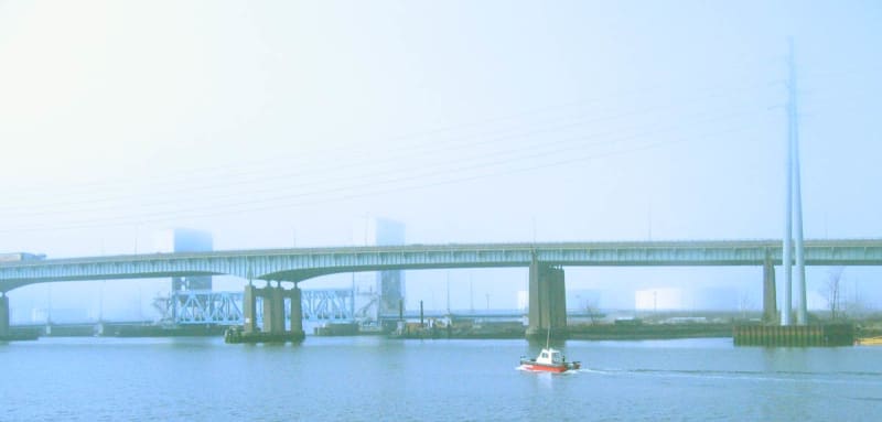

The below photo is the Quinnipiac River Bridge (I-95) in New Haven CT. When it opened in 1958 it had the deepest plate girders in the US.

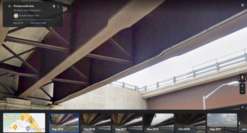

I live in NH and somehow recognized the location. This is at the intersection of Routes 108 and 101 in Exeter. Looking up from below, there are stiffeners at a spacing somewhere around 2-3 times the girder depth. From other pictures on google streetview, it almost looks like the shadow lines match what you would expect to be the web members of a truss. The lines seem to be mirrored about the middle. The pictures on streetview aren't great though, and perhaps I'm imagining this.

The next time you get a chance, look on the inside face of the web and see if there are transverse stiffeners like in the following.
That's exactly what I was thinking.... That they left the stiffeners on the inside of the bridge so that the exterior looked better. But, that the fabrication caused some minor warping visible from this side.
I think they're shear deformations ... incredibly small amplitude, completely elastic, highly visible (due to light distorsions).

It’s not a buckle, it’s an elastic shear deformation. [smile]
I use the term "oil-canning". I've seen it in a number of bridges with slender webs. The paint and lighting probably make it more noticeable here than on other structures. There is some discussion of the issue in
