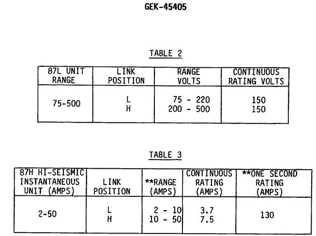

Can someone help me read how this differential relay is set? 2
bdn2004
Jan 27, 2007
794
The actual trip time? It is a GE PVD Differential Relay.
See the attached (2) pic file of the relay and a cut sheet.
It is connected to a 3000/5 CT, on a 12.47kV bus. The card on the front says it is set at 135V, and 2A.
The cut sheet says its typical operating speed is 20ms (1.2 cycles) at 4X pickup.
Our data from a test report shows that this is set at 0.083 seconds (5 cycles).

I'm guessing you meant 1.2 cycles instead of 12 cycles.
Here is the time curve from the PVD manual. I don't see how they were getting the relay to trip at 83ms, unless they were measuring the trip time from the lockout relay possibly.
Both the 87L and 87H are set to Low Setting via the range selection bars.
The 87L setting is set by turning the black knob in the center. Low range is 75v to 220v. I'm not sure what the dots around the dial refer to.
The 87H setting is set by adjusting the core of the 87H unit (screw on top) up and down. Low Range is 2 to 10 amps.

The voltage setting is determined by calculating the minimum voltage that would occur for an external fault (one where you don't want a trip) with one CT completely saturated. For an internal fault, the voltage will be equal to the CT current times the MOV resistance, limited by the CT saturation. For an example, with 1200:5 CTs and a 4800 A fault, CT current will be 20 A. Voltage through a 2000 ohm MOV would be 40000 V if there were no saturation, but CT saturation would limit the voltage to some point above the CT knee point. If C400 CTs were used, the voltage would be around 400 V, or 3 times the set voltage. Operating time would be around 21 ms.
