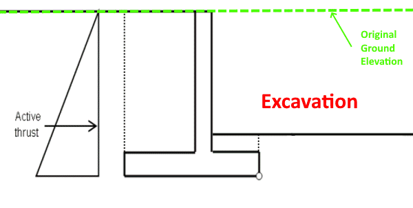

snipit - You are looking for an answer to apply to all situations, few exist in engineering. Dealing with that is a large part of our jobs.
Based on your question, I will give you three specific examples why there are few absolute answers. In these examples, the "answer" will be different in each case, there could be variations on those answers, and all answers could be correct (at least correct enough).
1) Retaining wall is constructed on "high" ground, with excavation in front of it:

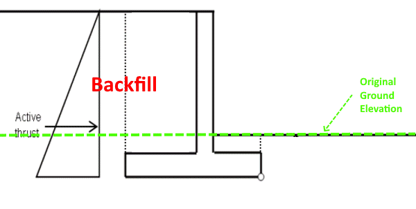

2) Retaining wall is constructed on "low" ground, with backfill behind it:

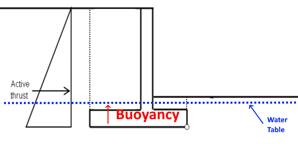

3) Where I worked, water table is at or just below ground level. I had to account for uplift from buoyancy:
