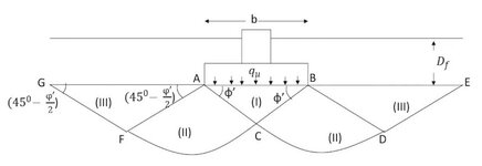

Does anyone know how to determine the width (in the figure, BE) of the failure wedge?

For my research, it is necessary to find the width (in the figure, BE) of the failure wedge in Terzaghi, Vesic, or Prandtl bearing capacity theories for shallow foundations. I searched the literature but could not find any equations or calculations. I tried the trigonometric method, but the resulting value was too large compared to real-world observations. Does anyone know how to determine BE from the figure? Thanks!
N.B: in my calculation, I found BE= 2.2 m (Terzaghi), 2.70(Prandtl) for 200mm diameter, Angle of Internal Friction 45-degree, foundation (physical Model).
Arc CD or CF , Log spiral Line and defined by the equation;
ro= BC=AC Notice that r=ro if ϕ=0
Angle theta is angle of CBD =135 – ϕ/2
( E.G . For ϕ=30 degr , then theta =135 – ϕ/2 =120 degr= 2.094 rad. if ro=1.0 m , r=3.35 m )

I did! But does a 2m failure wedge length (BE) make sense for a small 200mm circular footing? It's 10X of the foundation width. That is the confusion.

It doesn't make sense for 200mm circular footing 2m failure wedge length (BE). Assume ϕ=30 degr. and AB=0.2 m,
ro =0.1* COS ϕ= 0.087 m
Angle theta CBD =135 – ϕ/2=120 degr. =2.094 rad
r=ro*e^(2.094*TAN ϕ )=0.30 m
BE= 2*0.30*COS (45 – ϕ/2)=0.52 m or 520 mm
