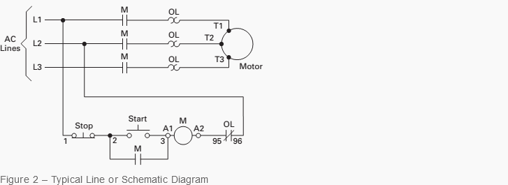

When I first encountered standard motor control diagrams, over 50 years ago, even very old texts and Motor Wiring Diagram Books placed those contacts exactly where they are shown in the diagram.
It has to do with the factory construction and factory wiring of magnetic motor starters dating back for much longer than 50 years.
In the early years, line voltage control was common for magnetic motor starters.
Screenshot_2023-08-15_at_18-21-29_Basic_wiring_for_motor_control_-_Technical_data_guide_EEP_gtvbhw.png
The jumper from the sealing contacts "M" to the coil, "3" or "A1" was factory installed.
The jumper from terminal "A2" on the coil to terminal "95" on the Overload contacts was factory installed.
The jumper from terminal "96" on the overload contacts to line 2 was factory installed
The industry trend has been away from line voltage control to separate control sources.

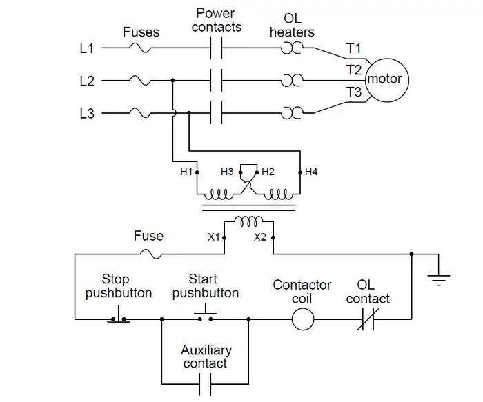

This is a typical modern wiring diagram:
The original wiring diagram has been replaced with this diagram, and the connection of the overload relay in the grounded circuit conductor remains.
The internal jumpers are still factory pre-wired.

c) The TR1, TR2 and TR3 N.C. contact shall be placed on the fused line i.e. NOT on the non-fused line. WRONG.. Did you mean FR1, FR2, and FR4? Those are the contacts on the overload relays.
1. Thank you Mr. waross. You are RIGHT. I mean FR1, FR2, and FR4,the N.C. contacts on the overload relays. The drawing was unfortunately rather blur.
2. Your second schematic showing the OL N.C. contact with one end connected to the contactor coil and the other end to the grounded line is WRONG. This is equivalent to switching the grounded neutral.
3. A simple illustration would show the flaw:
a) with OL N.C. contact placed after the contactor coil with terminal say a and b, when b is shorted to ground; the contactor would remain energized during OL. This is unacceptable!
b) with OL N.C contact placed before the contactor coil, the OL would trip the system even the coil terminal b is grounded.
Che Kuan Yau (Singapore)

My diagram shows what has been the standard, pre-wired North American standard for Magnetic Motor Starters for at least 80 years.
It is a universal convention.

"....It is obvious that you have zero North American experience, Mr. Che My diagram shows what has been the standard, pre-wired North American standard for Magnetic Motor Starters for at least 80 years.... ".
My opinion is : Your second schematic showing the OL N.C. contact with one end connected to the contactor coil and the other end to the grounded line is WRONG..... with OL N.C. contact placed after the contactor coil with terminal say a and b, when b is shorted to ground; the contactor would remain energized during OL. This is unacceptable!
Your learned advice on the "opinion" is welcome. It is irrelevant whether it is the standard practice for at least 80 years.

Yes, but we are concerned with a jumper from the coil to the O/L relay, typically not exposed to any external damage.
In many cases this jumper is less than 3 inches long.
In many many years grounding of this jumper has never been a problem.
And yes, as in all things, there may be the odd exception.
The German firm, Klockner-Moeller is an exception. Klockner-Moeller does not wire the overload relay in the grounded conductor.
Of course, they prewire their equipment to their own scheme.
Are they, wrong?
No, just different.
We are happy to use their equipment, but first time users are often confused until they realize that K-M follows a different standard.
