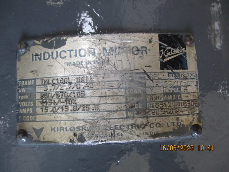

The present motor is 3 windings 3 speeds (6, 10 and 32 poles) and they are all squeezed in the same slot space and they fail often due to frequent starts. My idea was to have to one winding with generous copper and do the VFD do the required speeds and cycle times. Accel/Decel times option for each speed would be great too.

Hi, edison,
I'm just curious. Do you have a photo of the motors's nameplate?
How many slots does it have?
ACW
Stator/rotor = 48/65

Wow, even 25 Amps at 0.42 kW and 13 Amps at 2.2 kW and 15 Amps at 3.7 kW!!!
It's obvious that the motor is intended for some short-term duty-cycle.
I believe rewinding it won't be easy either.
Attempting a redesign with 6 poles and supplying power through a VFD is a very clever idea.
Notice: consider redesign to 8 poles in order to avoid 48 slots/6 poles winding that is always more or less unbalanced.

Yes, the power will go down with the speed as the nameplate shows.
