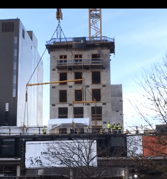

It seems overkill to have each cable/connection/spreader bar designed to carry half the load of the unit. We're taking care to ensure that the cables are the correct length such that the weight is distributed across all the cables.
Here's a youtube video of what we're hoisting.
Retrograde, Lomarandil and skeletron, (and any others) would you still assume each connection is carrying half the unit weight, or do you think my method is fine?
I would still assume that at least 2 of the legs aren't contributing directly to carrying the load of the module. Remember, you're not just dealing with pure gravity loading. You'll have wind, you'll have dynamic accelerations, etc. Sure, they may be small, but they'll be there. And rigging is not the place to cut corners.
Everything is overkill....until someone gets killed.
When I say cut corners I'm not implying you're trying to do something shady. Sorry about that. I mean it's no place to "sharpen your pencil."
One thing we know for sure is that the centre of gravity of the load in the video is directly under the crane hook. See below.
In the rigid plate illustrated in the OP, we know the location of the centre of gravity of load, but we do not know the location of the crane hook relative to the load. The center of rigidity shown on the sketch in the OP is not correct because the spring loads are not equal. In any case, the center of rigidity has no bearing on the problem. The plate will migrate to a position where the c.g. of load is directly under the point of suspension (the crane hook).
In an actual lift, the c.g. of load may not be precisely known, so the load distribution to the lift points cannot be precisely determined. For that reason, as well as the possibility of wind forces acting simultaneously, some conservatism and good engineering judgment is required.
BA
The idealised solution won’t match the actual loads. I’d design each point for half the load.
Alright, if you're talking about multi-level rigging with spreader bars, the problem changes somewhat. I would not design such a pick with 6-8 pick points as though each point carries 50% of the total unit, because if so, the spreaders would not be in equilibrium. Although I would not design them for 1/6 or 1/8 the load either.
Replies so far have mostly presumed multi-leg rigging connected to the same hook.
One other possibility is rigging with snatch blocks that force equal line loads (not equal vertical components). But that can often be more complicated than it's worth.
What rigging arrangement are you intending?
just call me Lo.
If the actual cable length is only millimeters different from the theoretical this could have a large influence on the load distribution. In my part of the world, workplace health and safety regulations mandate that you consider the full load be taken by diagonally opposite legs (although this may not necessarily apply to multi-level rigging - the principal is the same though). I would be surprised if similar didn't apply to you.
