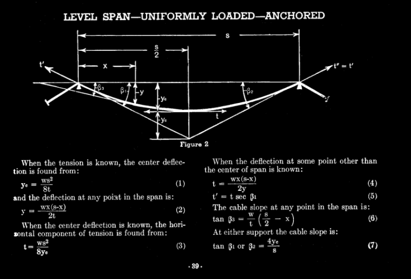

I feel like I've found a thing that doesn't work the way we've been taught in school.
My company does buildings with batting cage nets pretty frequently. We end up adding huge steel to support the massive loads that the tension cables should be putting on the building. In my example, the batting cages are supported by 80 ft cables that support netting that weighs 10 plf and will be allowed to sag no more than 4 inches. It doesn't sound like much by my calculations and those of my colleagues say this should be loading each end with 24 kips of force.
What doesn't make sense is that the batting cage submittal (attached) says that the cables are only good for 7 kips of tension and should be installed into 2x8 wood material. Also customers routinely tell me of buildings they've done where they just went and installed these after the fact in a building that wasn't designed for it and everything's fine.
I think they're right and I think that these don't truly load the building as much as my cantenary equations say they should.
Am I doing something wrong? Anyone got any ideas?
Are you sure the weight is correct? I was just handling similar mesh at my son's baseball practice. An 8ftx8ft section couldn't have weighed more than 2 pounds.
You cable tension formula looks off at a quick glance. This is from the wire rope guide on sliderulaera’s site:
Edit: your formula looks like it expands to the same expression. Agree with Pham 10plf seems high for this and a 4” drape sounds to tight for the primary cables, I’ve seen the support cables have 1ft+ of drape.

At 24 kip, that cable would have about 4' of stretch in it. Do they come back and tension the cable after the net is installed?
