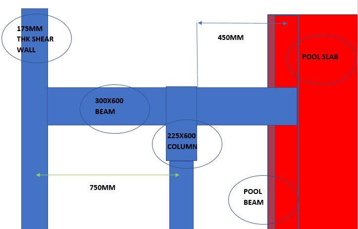

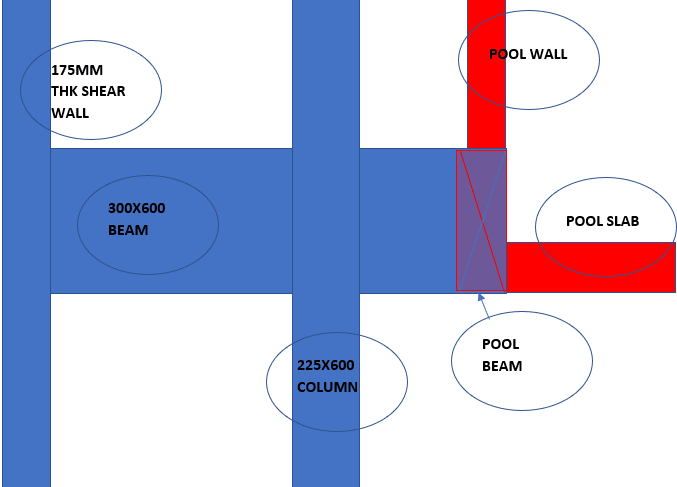

Hi !
INTRODUCTION
I'm forced to design a short cantilever, which has an equally short back-span. The c/s of the cantilever can be 300mm wide and 600mm deep. The cantilever is protruding out from a 225 x 600 RCC column, and also has a back span which connects to a continuous shear wall. The c/c distance between the shear wall and the column is 750mm and the cantilever length is about 500mm.
1. Now, the problem is this. The in-plane moment acting on the cantilever beam is negligible.
2. The axial load on the cantilever will be 380 kN at ULS.
3. There will be a significant torsional moment on the cantilever, which is 180kNm. This is transferred by the pool beam, which will be transferring 50% of the pool s/w , water load and live load. So this 180kNm would act as torsion, if im not mistaken.
QUESTION
1. Should I design this as a corbel, cantilever beam or a horizontal shear wall ?
2. Corbels are generally designed in such a way that the load transferring component transfers only forces, and rarely, moments. Not torsion in any case.
So, how do I tackle this problem?
Thank you.
