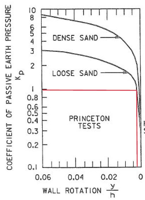

full passive pressure generally required only a very small movement (0.003 or less for half passive), so if you can stand any movement, you may be able to justify using it. For your 10 foot wall, that would be about 1/3 inch.
avscorreia, AASHTO LRFD puts a load factor of 1.5 on lateral earth pressure for the structural design of flexible walls, probably for the reason you mentioned.

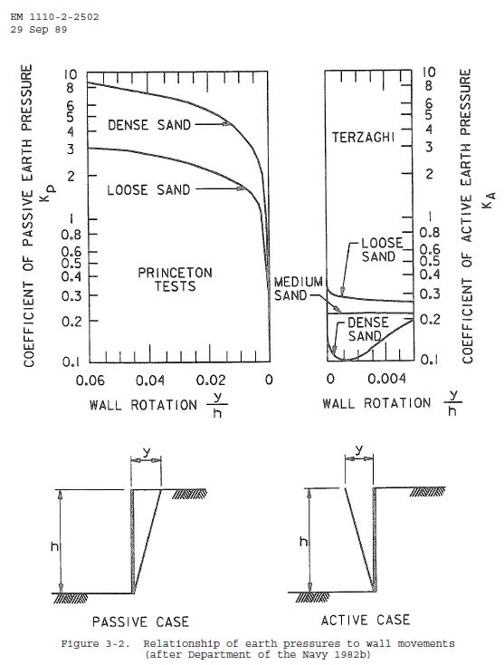

According to your graph as I read it, cvg, you don't get anywhere near full passive until 0.02*H, which for the case of the 10' (120") wall would be 2.4".
HotRod10, I forgot to mention: I use the Eurocodes so I use a 1.35 load factor on lateral earth pressure, so you're probably right regarding AASHTO LRFD.
check again, you are misreading the graph. 1.0 Kp is at about .003 for loose sand and less for dense sand
What I considered "full" passive pressure for loose sand would be Kp = 3; half would be Kp = 1.5, corresponding to movement of nearly 0.01 ---> 1.2" for the 10' wall. It's similar for dense sand, with full passive being Kp = 8 and half being Kp = 4, crossing at a value slightly over 0.01.

nobody is recommending that full passive pressure be used. corps of engineers and navfac recommend no more than .5kp and only if you cant achieve stability using at rest pressure or you have a deep structure. according to the chart, .5kp would require very little movement, about .001 or .002.

For 0.5kP, EC7 indicates 1.1 to 4% of wall height for loose to dense sand, 0.011 to 0.04 x H. Thats 10 times more than cvg's Department of Navy reference.
I am sure that both methods were developed based on retaining wall monitoring at some point in time, but my gut says that 0.001 to 0.002 x H for 0.5Kp is too small a movement! For a 10ft wall thats 1/8" to 2/8" or 3 - 6mm.
