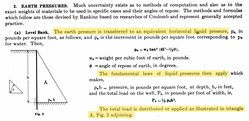

The Equivalent Fluid Pressure (EFP) of soil:
1. Depends on two, and only two variables, the unit weight of the soil and the soil's angle of repose.
2. The one, and only one correct way to use this EFP is to consider the soil to be an ideal liquid that performs as an ideal liquid.
3. Based on Item 2 (above), when using EFP the horizontal dimension of the soil is not a factor.
Don't believe it... here are three authoritative sources from past and present to confirm it.

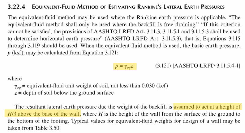

From: "Highway Bridge Superstructure Engineering: LRFD Approach to Design & Analysis", Taly, Published 2014, Page 313

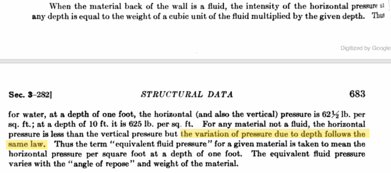

From: "Handbook of Building Construction", Hool and Johnson, Published 1920
From: "US Steel Sheet Piling Design Extracts", Published c. 1932

If I were being unkind, I'd say throw it and anything that mentions it in the bin. As SlideRuleEra's source says in section 3.22.4: "The equivalent-fluid method may be used where the Rankine earth pressure is applicable." Rankine coefficients are so simple to derive and use there is no reason to start talking about mythical fluids. If, however, you choose to use EFP and don't know how the EFP numbers were derived, best stick to what SlideRuleEra says.
2. Is EFP conservative in this case?
Maybe so. Use one of the other methods mentioned in this thread or linked threads and compare to Rankine. I don't think you'll end up with a hydrostatic lateral pressure distribution though, so it won't back-convert to an EFP.

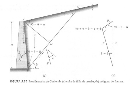

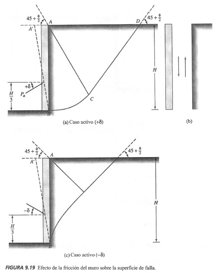

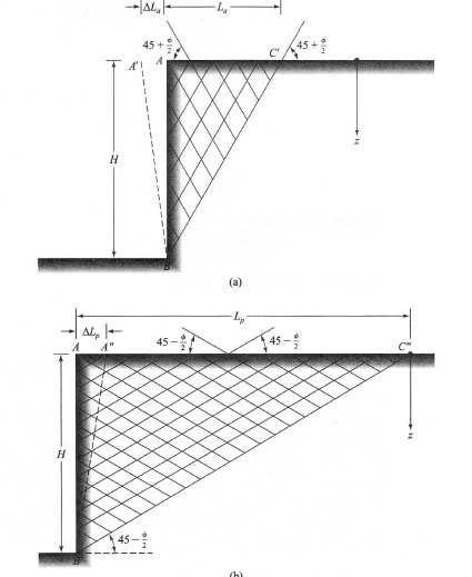

some of the assumptions for earth pressure is that the substrate is considered uniform and infinite. That's why that factor isn't reflected in equations.
I'm far for being able to give a proper answer, because i'd never researched to deep on something like this. But i'll give you the following images, just to note that there are several ways to estimate the backfill pressure depending on differents assumptions and also the coloumb scheme (with infinite width substrate) which match the equivalent "water-pressure" (only when the substrate is width enough).
