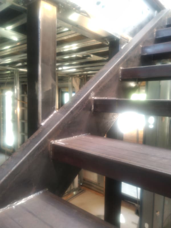

Hi, I recently installed these , design was submitted to my engineer. We are fighting small vibrations on the treads.
I'm wondering if I can use a vibration app on my phone to see if it's unacceptable.
I realized that I need more posts to weld my stringer to in order to stop vibrations, issue is I can't fit anymore in the wall , there is an seismic x brace in the way.
What can I add to make this work ?
Stringer is c12x25/ treads are c10x15.3

A 'structural handrail' to tie the cantilever ends together would *probably* damp vibrations.

Could you make the stringer a box section and also weld in some rectangular cross plates before adding the cover to the outside?
won't be easy now it's in place.

Just realised the stringer is a channel.
Yeah that needs to be a box section for sure.
You might want to try to add a cover plate on the channel to box it. That will help a bunch - but, yeah, that should have been a beefy box section.
Your engineer is a dummy to think a channel was a good plan.
Paint it Safety Yellow?
I'd like to see the torsion calc on that stringer.
It looks like a large rect HSS section and not a channel... should be easy.
dik: he says the stringer is a channel in the OP. I also made that mistake looking at it but apparently it's a C12x25
I'm with XR250 and GeorgeTCE. Probably would look at adding a plate on backside of stringer to box the section and then ensure the handrails on the opposing side are rigid / welded moment connections (edit - of beefy proportions) to help stiffen the free end.
Everyone has the same idea. That concludes it....Plates are very good at resolving vibration related issues (due to the stiffness in plane) in stairs depending on the usage. Adding the handrails, all are solid and you're ready to run down this stair. [bigglasses]

I welded alot of flat bar stiffeners inside the C section of the stringer (2) per tread top to bottom.
I also welded a 2x3/4 flat bar on the top flange of the stringer. To stop torsion.
As seen it's very strong, we have very little vibrations at this point.my eng is done with it I think and I can't determine the natural frequency of these stairs on my own, or can I with my phone ?
Boxing the channel I should have done in the first place yes.
The box plate would have to be at least 3/8 thick ? So about 14" wide , and can it be sections of plate or does it have to be one full length plate ? (Sections would be easier at this point.
The treads I welded as partial penetration welds 6mm throat to the stringer CWB 7018 stick.
My engineer did suggest adding a plate the open end , clients want an open look.
In the future, would say a 3x12 X3/8 wall rec tube be a better stringer ? Or keep using the channel and box it off ?
I found the rec tube stringer wall wants to bend , and I have no access inside to add stiffeners so I like using an open member like c channel.

I imagine that the handrail will be point fixed glass. Sketchy as it will be to rely on that for vibration control, it will help some.
In my experience, there is a good chance that turning the channel into a box will not get the job done, despite that being a generally fine idea. If that comes to pass, it will likely be because the connections between the stringer and its supports are, themselves, unsuitable for resisting torsion. So there might be some work to be done there as well.

The trouble with that lies in deciding what will be deemed "acceptable". That will, usually, come down owner perception of footfall vibration of one person traversing the stair in a residential structure. Concerns for group lockstep etc are the domain of institutional stairs.
I had one stair vibration issue that went on for a couple of years. We added landing bracing, concrete filled the HSS stringers, and a bunch of other stuff. It still resulted in a cantilevered landing swaying 2" laterally under one person's footfall. In the end, the owner decided that it made for an interesting conversation piece for his guests and just left it as is. This speaks to the fluid nature of "acceptable" when it comes to serviceability issues on the sexy stuff.
It can be sections that get nominally connected together at the joints in the field. Even without the connections, the plates might be enough to stiffen things up acceptably, it's difficult to say.

I find that the posts (floor to ceiling) that I installed (4x4x1/4wall) helped the most, I'm going to maybe :
Put (2) 2x2x1/4 wall tubes , weld them together and make another post that will fit in front of the x brace in that wall and weld it to the stringer.
The vertical post make the tread crazy stuff , I just wish I could get more in there and I would have been done with this a month ago lol
