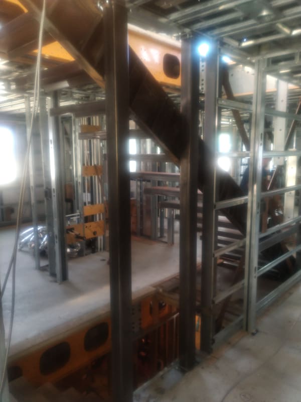

Hi, I recently installed these , design was submitted to my engineer. We are fighting small vibrations on the treads.
I'm wondering if I can use a vibration app on my phone to see if it's unacceptable.
I realized that I need more posts to weld my stringer to in order to stop vibrations, issue is I can't fit anymore in the wall , there is an seismic x brace in the way.
What can I add to make this work ?
Stringer is c12x25/ treads are c10x15.3
I'm new here. Can I add Multiple pictures?

Could you reduce the tread length?
But basically they are long slender cantilevers with variable force and weight being applied.

I don't really understand the process here. It sounds like you are randomly welding things to this stair and hoping for the engineer to say OK. Did this engineer design the stair originally? Are they the EOR and this was supposed to be a delegated design? I would think the vibration of this thing would be treating the tread as a cantilver from a spring support which would be the torsional stiffness of the stringer. I would look at the softest area and run an analysis. As others have said this stringer should have been a tube from day 1, but the added verticals will help reduce the torsional span by some amount that will likely help.
In general though vibration for something like this is perceptibly and comfort, not life safety. If the client says OK, and maybe can provide that OK in writing, this should be a done deal.

Yes, and it is often checked against a 4.6%g for a rapid descent. That's when the worst vibrations are felt. If you can get the frequency of your stair to be +5Hz you should be fine. A normal descent is around 1.7%g so if you are getting vibrations from a normal descent then that's a major problem. You can't always satisfy the 4.65%g so you can decide to go with maybe 3 or 4, at least people can walk on the stairs while ignoring vibrations when someone runs down.
From the look of things, the options I see are boxing them and adding handrails to dampen your stair.
I had a couple of articles on vibrations in stair design I may have to dig into my files but if my memory serves me right you can get about 2% damping from the handrails (depending on the type of handrails used). Another thing which might ruin your design but adding z bent plates connecting the treads. To me that just extra cost and labor for no "concrete" reason (See what I did there.. concrete [bigglasses])
