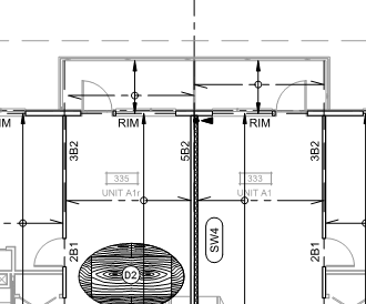

Where I am from we see a lot of balcony beams aligned with wall then cantilever out. See below.

@dhengr, you are right I don't know why did we start we specifying PT lumber. But the intent is to get wrapped all around with waterproofing membrane (top, side and bottom of balcony framing). These are not exposed. The reason for providing separate member rather than cantilevering just the floor framing is create level difference.
@phamENG I believe you are referring to water intrusion at penetration. If the balcony framing is protected with membrane all around and sloped rigid insulation for drainage, will this be still an issue? The deck will be overframed on top of the rigid insulation with pedestals to level them.
