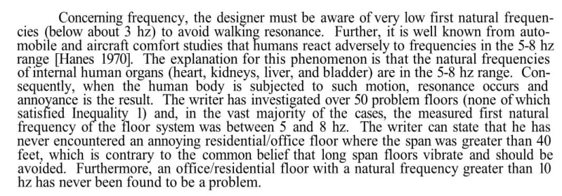

We might model that in RISA and do a dynamic analysis to get the frequency of the beam. Try to keep it higher than 5 Hz.
JAE, for my own curiosity, where do you get 5 Hz? Is this based on the AISC Design Guide for vibration control (forget which DG number)? Vibration isn't an aspect of the design that I normally check, and I've been meaning to look into this more.
Yes - it's a very rough idea of a limit for human comfort I believe. Perhaps based on this from a Thomas Murray article:

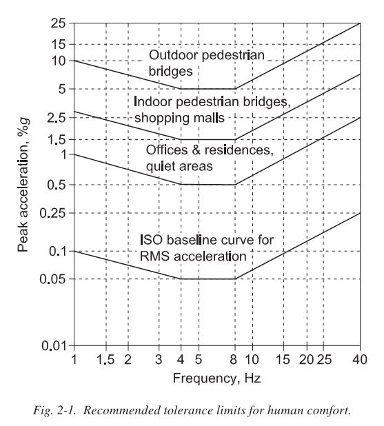

Also from Design Guide 11 there's this old chart that is helpful:
