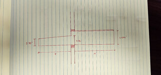

NDS says that notching for a beam at the bearing point can be 1/4 depth per Figure 4A, NDS 2018. Does this same figure apply when cantilevering a beam, for example a house to deck, where the notch would occur on the top face where the deck steps down. When cantilevering from house to deck the simple span portion would have unnotched bearing. Is there different criteria to follow?

Are you saying this is what you do all the time? Over 4" of notch?
I haven't done it personally but, yes, that is something quite common in my area.
It's a pretty serious no-no from a fracture mechanics perspective I think. Big old tension stress at a high moment location etc.
That said. I really do not see it failing catastrophically. I would expect that you'd just develop a crack from the notch up to the the top of the full depth section at a relatively shallow angle.

Yes...I would agree. Wasn't an option in this case. Needed 4 7x10.33x 18' long PSL's stitched together to take a point load. Client wants Trex on deck over living, so that's why the 11.875 depths are notched down to 7.75" and then sloped to 5.75".
I didn't want to do this, but what we did to account for notch requirements in NDS is put a horizontal cut at 7.75" for 24" back to keep stress cracking from occurring. Then, left the 11.875" depth joist in interior to flush with rest of the floor.
I just couldn't find any research on cantered notching for my situation.
If 1/6" notch works, and I simply add fur strips to the top of cantilevered joists to flush with the floor, what is the difference if I left the full depth of the 11.875? Does the stress fracture occur in the 11.875" because the neutral axis is higher than the depth required for 1/6 notch, (9.3"), which would then lower the neutral axis and push it further from the tension face at top of peak moment region?

I'm confused because above you say they are notching 11 7/8" members to 7 3/4" then sloping to 5 3/4".
Treated PSL's only come 3.5" & 5.25" widths and 9 1/4", 11 7/8", 14", & 16" depths. How are you getting from 11 7/8" to 5.75" without ripping them down?
why not terminate the heavy beam at the support, and extend (sister?) with 2x6 pieces ?
what is the reason for the notch ? what is filling it ?? so narrow decking ??
I guess you're calling the overhang a cantilever ? I guess you're emphasizing the moment at the end of the notch ? which wouldn't be much ??
The heavy load is to the right of the support, no?
Because there is no room to sister with 4 7x11.875 beams stitched together to take the load at the end. Too much deflection at the end to put a large joist in there. So, either notch, or just fur up shorter joists, or use full size and put a horizontal cut at the deck notch to prevent some kind of fracturing at that point.
