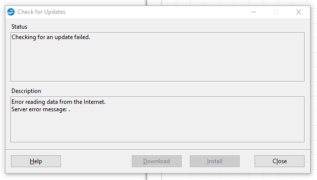

I'm running Version 4.1.7. but the help file gives an error message when I check for updates.

I got the "checking for an update failed" screen when I tried to update from within the program, so I downloaded the full program and installed from scratch.
