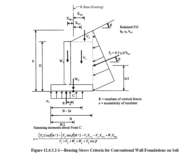

Can you clarify the calculation of R & e for a case with 0:1 backfill slope (flat)?
R and e are determined as what is needed to produce equilibrium, based on the loads applied. In the case of a flat backslope beta goes to zero, which means Ft (the force of the retained soil) is applied horizontally, rather than having vertical and horizontal components. I'll post the equation that goes with the figure tomorrow when I'm in the office.

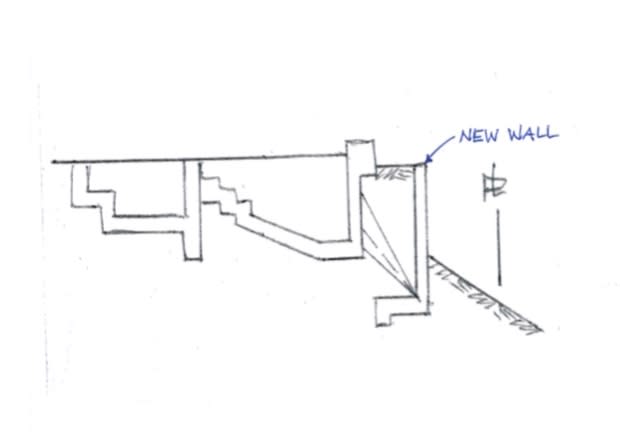

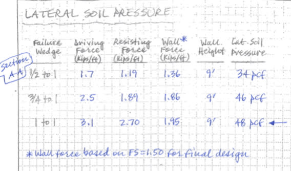

The pool is approximately 5’ from the wall. With reference to the below calc and figure, the geotech seems to be treating the pool as being lighter than the soil it displaces, and accounting for the surcharge by treating it as a “failure wedge” for a 1:1 sloped backfill condition, resolved into the 48psf/f EFP.
Given those conditions, if it was me designing it, I'd use at-rest pressure, since any movement of the wall could be detrimental to the structural integrity of the pool. I'd also neglect the passive resistance of the soil in front of the wall, for the same reason (it takes a significant amount of movement to mobilize passive resistance), and also because there's no guarantee that the soil will always be there.
OP said:
The geotech tells me that 48psf/f accounts for the pool. The EFP in locations away from the pool is 30psf/f.
I think you have reversed the order - 30 pcf at the pool, the lower earth pressure is due to the limited fill depth between the pool and the wall; 48 pcf everywhere else. To further reduce the earth pressure, I suggest looking into using a lean concrete mix as the backfill.
Since the wall is on a slope, you shouldn't utilize the passive pressure in front of the toe, it can be easily lost - washed away by rainstorms, soil corrosion...
I would tilt the wall towards the pool in anticipation of excessive lateral displacement. Also, it may be best to place the wall on piles.
