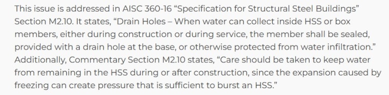

Ran into a first today. We got a call from a contractor that discovered that several feet of water had gotten inside the HSS columns as the fabricator had omitted the cap plates on several of them. Many of these columns already had drywall around them, so they've got to do a bit of work and re-work to adequately drain them and get everything buttoned up again. He is looking for any written requirement or codification that he can use as recourse against the fabricator as I assume they're going to try and recoup the cost from them. Does anyone know if cap plates are a requirement on HSS columns and, if not, if they require weep holes if a cap is not applied?
I did some looking but couldn't find anything in AISC or online.
Thanks.
Possibly. But Section M2 is titled "Fabrication" so...
I think what XR250 is suggesting is that the wording is not "AND otherwise protected" but "OR otherwise protected", which means only one or the other is necessary under the standard. Since no drain holes were provided on the shop drawings (I imagine?) the fabricator could say "duh...you were supposed to protect them as you knew there were no cap plates / drain holes on the shop drawings...remember GC, the ones you reviewed? I just put up the steel you are required for all temporary measures. It's your site remember!"

Here's the reference for completeness.
AISC 360-16 Specification

If the fabricator doesn't provide them, well, the GC did get a chance to review the shop drawings before fabrication, and either they accepted it, indicating they were going to keep the thing dry, or they failed to mark it up. It would be better in the defense if the fabricator specifically called out the lack of a drain hole for the GC to confirm/accept with a cloud. Or just provide it, and if the drawing comes back with it crossed out, you know who made that decision.
As a side note, I tracked this provision back to the 2005 AISC 360. It's perhaps in the 1997 HSS specification but I didn't find a searchable version of that and I didn't see it in the 1989 Specification. So this is perhaps a lurking issue for folks to be aware of.
