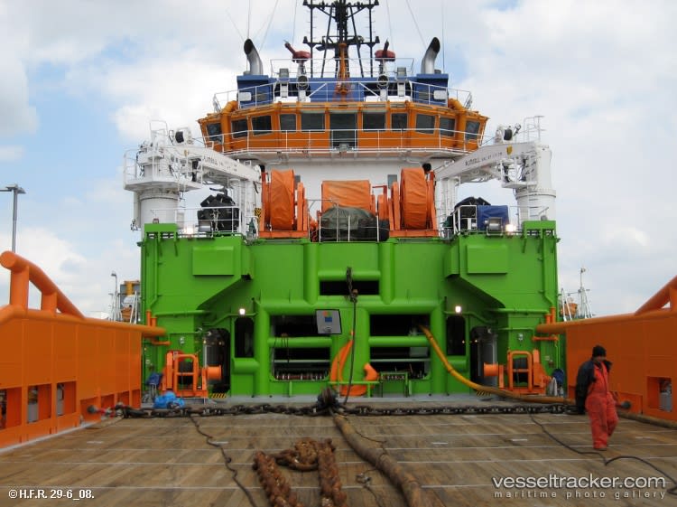

Its was a Schmitt Boka that was towing it I think.
Schmitt are definitely EU rags so will need hydraulic shears to cut the cable.
but if the rollers were hardened wouldn't movement of the wire rope start fraying the rope?
That tug will have 3.5"ish towing wire. Shears would be quite large and I do not see such a device in the photo.
That orange hook shaped thing in the center, we employ a bunch of the descendents of its inventor.
LI, with soft steel, the cable just cuts grooves in the rollers and guides making the surface longer smooth which snags the cable. A drum will usually have 2000 feet of wire while a roller may only have 6 feet of circumference so the wear gets distributed along the wire but is quite concentrated on the roller.
