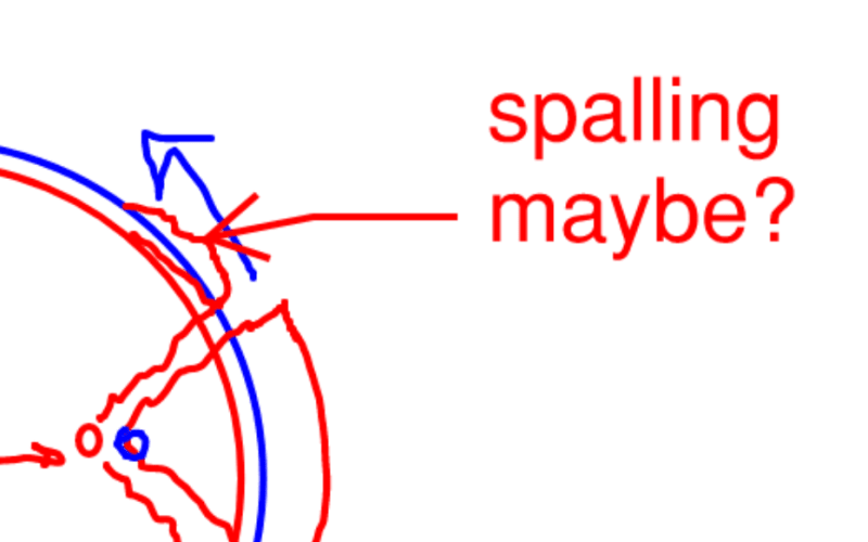

If that radial pressure acting inwards is present before the concrete breakout frustum forms then I agree, that would do the job. This is basically exactly what I was getting at when I proposed the prestressed steel collar above. The key to it, however, is that it prevents the shear breakout frustum from ever forming. Thus, the spalling potential is eliminated.
With the rebar/GFRP hoops, the character of the prestressed system is changed from that an active system to that of a passive system where no hoop stress is developed until after the shear breakout frustum forms. At which point the spalling issues likely neuter the thing per the sketch below. You simply have to move the failure frustum a fair bit before you develop meaningful hoop stress in a non-prestressed, passive system.

Certainly, there is some similarity. However, there is also a critical difference in my opinion. And that difference is that true confinement situations, ala Poisson, create a uniform hoop stress around the entire hoop such that the hoop is in complete equilibrium and nowhere subject to local shear or bending. It's this local shear and bending that ultimately doom the shear breakout condition.

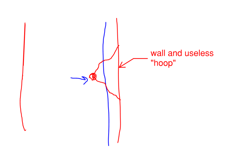

As I've mentioned previously, the effectiveness of the hoop stress is intimately related to the angle at which the hoop exists the potential shear breakout frustum. And that's a function of of the curvature of the hoop. A tighter radius of curvature will yield better results. In the extreme, imagine the sketch below in your mind's eye when the radius of curvature is so large that the hoop exits the shear failure frustum effectively orthogonal to the applied shear load. That's basically analogous to an anchor trying to pop out laterally through the top of a wall, right? And in that case, I think that we can all agree that the reinforcement would be ineffective.
The effectiveness of the hoop steel in any real situation lies somewhere along the continuum between awesomee ties parallel to the load and the useless "hoop" of the wall example.
