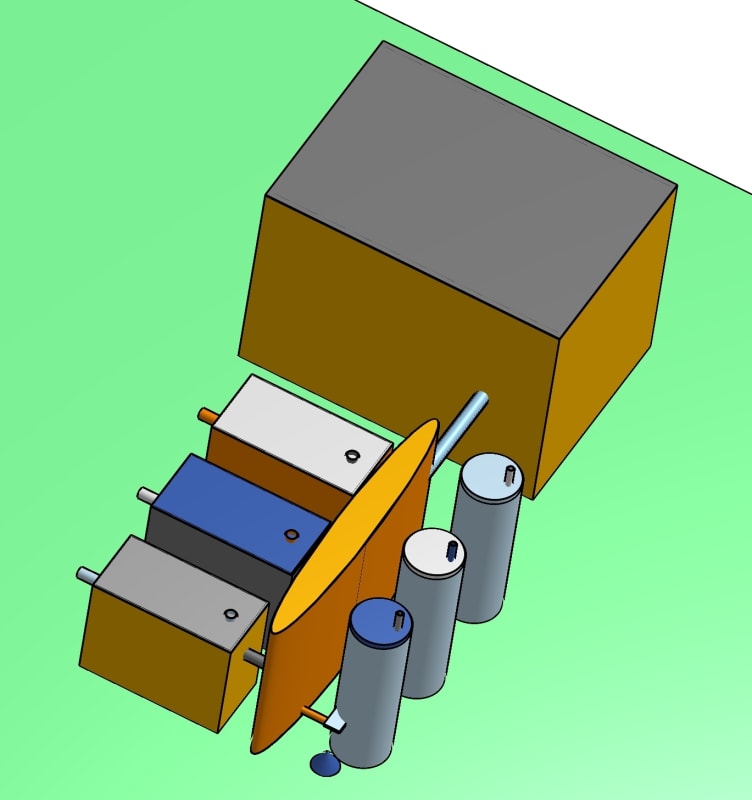

CO2 can be removed from the atmosphere and separated into solid carbon and oxygen gas. Essentially unburning carbon.
Switching to renewable energy sources will reduce CO2 emissions however it won't remove excess CO2 in the atmosphere as a result of the combustion of fossil fuels.
2Mg + CO2 ⇌ 2MgO + C
Solid carbon submerged is relatively inert and compact.
Electrolytically recovering the Mg and collecting CO2 will require energy from renewable sources. This is the mechanism that I propose. Does anyone have any arguments against using it to sequester atmospheric CO2?

2Mg+CO2⇌2MgO+C
441.5 x 48.61/12 = 1800 GT Mg
I'm using tons here.
I need about 570000 tons of Mg assuming that a lb of Mg takes 5 min to convert to MgO on pure CO2.
About.04 grams of Mg per person.
Or 950000 tons of MgO.
About .06 grams MgO per person.
The Mg is just a buffer atom. It's convenient due to its oxidation state.
The Mg⇌MgO equilibrium will be maintained by the electrolysis of MgO. Super heated CO2 injected into the molten cathode of the cell. O2 being released at a carbon anode.
Carbon should float up through the molten MgO and collected anaerobically to avoid C+O2 back reaction.
I need a million tons of MgO.
