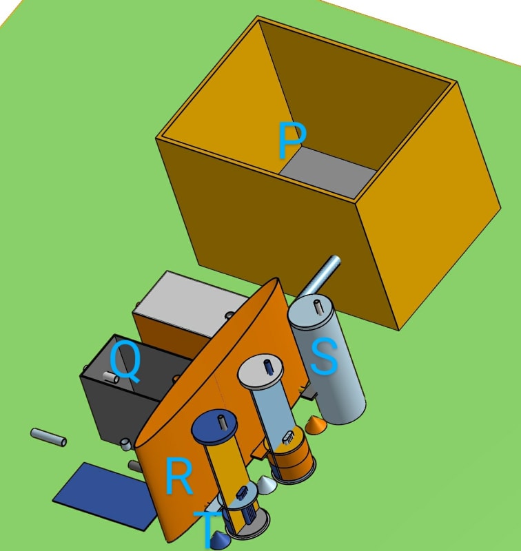

CO2 can be removed from the atmosphere and separated into solid carbon and oxygen gas. Essentially unburning carbon.
Switching to renewable energy sources will reduce CO2 emissions however it won't remove excess CO2 in the atmosphere as a result of the combustion of fossil fuels.
2Mg + CO2 ⇌ 2MgO + C
Solid carbon submerged is relatively inert and compact.

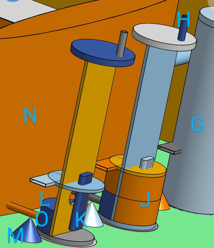

Electrolytically recovering the Mg and collecting CO2 will require energy from renewable sources. This is the mechanism that I propose. Does anyone have any arguments against using it to sequester atmospheric CO2?
Q - kiln MgCO3⇌MgO+CO2
R - pure CO2 tank
J - Molten MgO
K - carbon anode
L - molten metal cathode
O - CO2 injection site
M - carbon to be submerged H2O
Good - the Mg is all sorted out. 1 Million metric tons is the entire world's annual production.
Where's the energy coming from? You seem to have skipped that part.
And where does the cooling come into play - all that superheated material needs to be cooled somehow. Where does that heat go?
I do like the part where the carbon "should" float up. Seems like an easy experiment to run before committing to this technology.
Density MgO 3.58
Density C 3.52
Kind of close but might be enough.

I don't think we can afford cooling. Don't want to lose energy in the MgCO3⇌CO2+MgO reaction. Want to recover energy from 2Mg+CO2⇌2MgO+C for electrolysis of MgO.
At 100% efficiency CO2⇌C+O2 393.5 kj/mol is the net reaction.
100% isn't realistic. No reason to settle for an arbitrary efficiency number unless there is a physical law that dictates.

Suggest the OP studies the Magcan plant , just south of Calgary. Metallic magnesium was produced from MgCO3 Rock. Place went bankrupt despite very large subsidies from the government.
The sun provides roughly 10,000 times current human energy production. To make this a 30 year project takes 10% of that power level - so humans need to find a source that is 1,000 times larger than is in current use. Since wind and hydropower are solar powered, tidal has definite limits (it draws power from the Moon's orbital energy; how much before that changes?) that leaves nuclear (not happening, they keep going off line for a bunch of technical reasons) that leaves geothermal to get about 100,000 times more than it does now.

Is that at the process temperature for the MgO and is there proof of that? What is the solubility of carbon at the process temp? Should you have already demonstrated this on a smaller scale?

So unsound mechanism and not enough energy in the world to do it. I actually thought it was possible. At least now I can stop.
