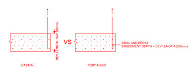

Hi All,
Does anyone know why the effect of edge breakout is more severe in post-fixed rebar with epoxy compared to cast-in rebar?
Say you're drilling a post-fixed rebar the same length as what the development length of the cast-in rebar, if you check it in Hilti or similar software, the capacity will not be even close to the yield capacity of the cast-in rebar due to edge breakout failure. While in cast-in rebar, there is no edge breakout if you embed the bar as development length. Please see snapshot below for clarity.
I'm asking this because there's a site issue with missing wall starter bars, and the wall is in tension at its edge. The post-fixed rebar needs to reach its yield strength to resist the tension demand.
Thanks in advance!

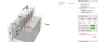

I meant the concrete breakout failure that is worse when your post-fixed rebar is close to the edge. Please see snapshot below for clarity.
Chapter 17 will limit your ability to develop the bar this close to the edge. You can design the post-installed rebar to behave just like cast-in-place rebar, if embedding beyond 20*d.
I'm assuming this is referring to ACI? Could you please guide me to which clause you are referring to?

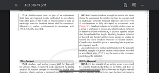

Where are you seeing this clause of concrete breakout doesn’t apply to embedments deeper than 20d? Based on below snapshot, full bar development does not preclude breakout on cast-in reinforcement.
Follow the code path outlined above. It’s not an anchor in the eyes of the code beyond 20d, so 17 doesn’t apply. Agreed; bar development does not preclude breakout, and I might be able to dig up an old paper that proves just that. But that has nothing to do with whether the rebar is treated as an anchor (<20d) or not. Don’t think I said otherwise…apologies for any confusion. We covered this in a recent thread:
