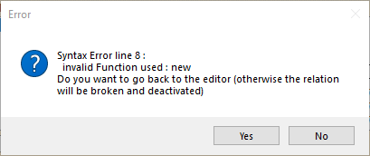

Hello all
i am trying to create a point using EKL method but i am getting this error
i have created a point also from formulas tab
i tried the following code from catiawidgets.net website
// Construct a Point by coordinates
Let ioPoint ( Point )
ioPoint = point( 0mm , 10mm , 20mm )
// Equate the Spec Object to the Point in Memory
`Part1/Geometrical Set.1/Point.1` = ioPoint
how do i create point or any other feature using EKL
your part name is EKL not Part1

How to create another point:
EKL need several things to create a point:
we need the point definition as (X,Y,Z) or any other definition (point on curve with ratio...)... (here we pass the definition to a point object)
Code:
we also need a geometric element to represent this definition, in the sample by Marc the geometry already exists as point.1 in geoset
Then finally we pass the definition to the geometry
Code:
so if you want to create another point you need to create a new geometry using the new (type, name, destination) function:
Code:
let myGeoSet (openBodyFeature)
myGeoSet = `Part1/Geometrical Set.1`
let newPT (point)
newPT = new("Point", "Point.2", myGeoSet )
this will create a isolate point (with no definition ) in geoset Geometrical Set.1
Then you pass a definition
Code:
newPT = point(1mm,2mm,3mm)
then you do an update
Code:
newPT .Update()

Interesting Eric! [medal]
However: in CATIA V5R32 my KWA reaction cannot recognize the "NEW" function...
