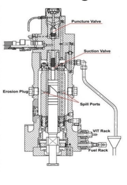

This is a variable displacement pump but I do not know the mechanism of operation. In another type of plunger pump displacement is controlled by uncovering a spill port. There is a pressure shockwave that causes erosion so a replaceable erosion plug is placed at the point of impact.
My problem seems to be that I am getting a similar shockwave on the suction side of my pump.
