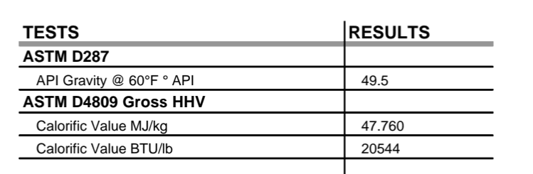

Let's say I have a compression ignition engine and I double the cetane of the fuel it normally runs on. Is it possible that the shorter ignition delay of high cetane fuels may reduce power at lower engine speeds with a fixed injection quantity and timing?
I ran two tests in a sample of the fuel that I believed would best explain a loss of power but the calorific value is actually very good compared to what I was expecting. I wish I had some diesel #2 to compare it to.
On a side note, is there any practical reason API gravity is used instead of specific gravity? It seems to unnecessarily complicate many calculations.

API gravity is used by engine manufacturers for a couple reasons, mainly it's what EMA (Engine Manufacturers Association) agreed upon early on, and when doing corrections for fuel consumption and power output, API gravity directly follows temperature variation, so as temp goes up, so does the API gravity, if you look at fuel correction charts may become clearer.
