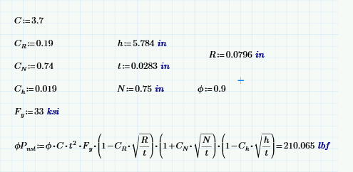

2) It turns out that the AISI doc on wall studs actually has a recommendation for track to stud capacity as shown below. Since it specifically mentions the stud being connected to both legs of the track, that's clearly being accounted for in some fashion and I feel as though I'd be remiss to claim any capacity above and beyond that. Luckily, the resulting capacity isn't too bad. Although the numbers appear to be higher than the SSMA numbers so I'll need to reconcile that somehow.
In case you were still looking into this/curious - I believe the SSMA tables are based on the same equation you show, but they use AISI S100 factors which are slightly different than the S211 factors (the wall stud doc). Just an FYI if you ever run into this again.

Hey KootK, AISI S211 Equation B2.2-1 includes a footnote stating the equation is only applicable for studs 0.0346 - 0.077 inches. If your stud is only 27 mil, then I would be want to check if it could still be applicable. Since you said the problem likely occurs at the top of the stud as well, then the design thickness for the studs is even greater for slip tracks. Did you look into this?
