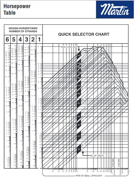

You will need to choose the appropriate chain size based on chain tables from a source like this

After digging through some archives and asking around, I have following information:
Chain – 22 ft. 200-2 Cottered Chain
Drive Sprocket – D200B17H x 5.1181 {130mm} (17 teeth)
Driven Sprocket – D200M60 (60 Teeth)
Also the GB ratio is slightly different from original : M1170DHC2-A-11.2 where 11.2:1 is Ratio as stated by 3DDave
The chain drive is existing and maintainence wise as most of you stated already is a pain. AN option to change to direct drive was given bu8t its expensive
Now, I am tasked with checking if this chain and sprocket spec correct for the conveyor system we have.
Material is Aggregates & approx. 1100 TPH.

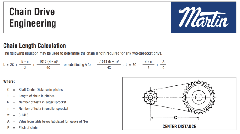

Is there a way I can calculate chain length (total or in pitches) & Sprocket PCD, # of tooth etc. with the information I have (except for the existing chain & sprocket)?
The chain length depends on the distance between the sprockets. Being that chain comes in inconvenient integers and is sensitive to tiny individual link length variations plus the inevitable effects of wear, you may need an adjuster or a tensioner. That is necessary.
Otherwise you can get close with using half the circumference of each sprocket added to twice the center distance. The half-circumference of a 60 tooth sprocket with a 200-2 appears to be 2.5 inch pitch, so 30 teeth * 2.5 inches per pitch is the length of the half circumference. 17 teeth is an odd number, that will change from 8 to 9 teeth engaged, but 8.5 teeth average will get close enough.
If the chain you have is 20 ft, then the sprockets are taking, roughly 8 feet of chain leaving, roughly, enough for 6 feet of center distance. This is not exact because the wrap on the big sprocket will be more and on the smaller one will be less, but not in 1:1 ratio. Check my math. I am unpaid and therefore only enthusiastic.

Is there a some way to calculate sprocket PCD & # of tooth?
PCD = chain pitch in inches / sin(180°/ no. of teeth in sprocket)
example
RC 200 chain = 2.5 inch pitch
60 tooth sprocket
PCD = 2.5 inch / sin (180/60) = 2.5"/ sin 3° = 47.768"
see page 31 of previously linked document for PCD of RC sprockets.
