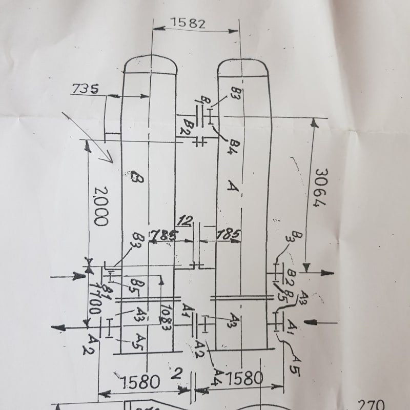

I work in a petroleum refining company. We have faced a problem in the middle distillates hydrotreating unit.
the change in the delta pressure for the outlet tube side of the second effluent recycle heat exchanger ( U bend tube) after the unifining reactor increased gradually from 0.2 bar to 4 bar.
knowing that ,
1. the reactor with heat exchangers have not be maintained for 20 years.
2. When we increased the capacity of the unit ,the delta pressure increased and when we decreased the the capacity ,the delta pressure decreased.
Can anybody help, why the delta pressure through heat exchanger tubeside increased ?
Increase in dp from 0.2 to 4bar for a TEMA U shell is a lot and cannot be ascribed to capacity increase alone, since (4/0.2)^0.5 > 4, which means capacity increase of > 300% - highly unlikely. It may be partly due to increase in throughput and/or change in viscosity of HDT product effluent or it may be due to reactor catalyst or some other foulant blocking the tubes. Time to take this HX offline and clean the tubes.

The question is why the first heat exchanger doesn't suffer from the fouling or clogged tubes similer as the second one.
Is the gravity play a role in this situation?
First HX temperature is probably running a bit higher than #2.

Original flow rate 42 ton per hour
New flow rate 50 ton per hour
Design flow rate 60 ton per hour
- pressure at inlet and outlet is shown in the document attached above
-fluid in the tube side is effluent
- fluid in shell side hydrogen
The heat exchanger is used to heat the hydrogen
Sorry but the diagram only has dimensions?
What about temperatures?
Another reason for "high dp at E1-B" may be that there is a low point piping pocket between E1-B and E2-A. Solids escaping from R-1 may be collecting in this low point pocket, giving the impression that E1-B is the location of high dp ( assuming the pressure guage is location somewhere downstream of the low point pocket). Reactor catalyst fines may be breaking through the bottom of the RX. Check the internals of the RX. Also the RX catalyst may have disintegrated through long term use or some kind of misoperation. So the solids may have deposited on the bottom row of tubes in E1-B and / or the low point piping pocket between E1-B and E2-A.
Based on the information supplied you have a serious blockage / restriction in the U tube of the second HX.
Removal and cleaning or replacement of the U tube section is required.
Only then can you see what substance is causing this blockage. You don't show the temperature in the d s side of the H Xs though.
