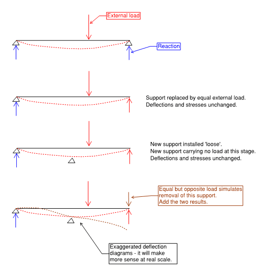

Starting simple, consider a structure where you remove a support. This happens fairly frequently during construction. You can model this by applying loads to the 'new' structure (ie without the support in question), at the old support location, that are equal but opposite to the support reaction that previously existed. This gives the effect of removing the support. Add the results to the previous results from when the support was in place.
You can extend this principle to whatever you remove from the structure.

Does that software allow you to force a displacement of a support? If so, that's all you need. If it doesn't, then you'll have to do it by hand.

Apply the negative reaction load to whatever your new structure is, including your added part. That's the general principle.
Edit: I'll expand on how this works. Remove the support but apply the old reactions as external loads. You get the same results as when the support was in place. Now apply opposite loads. There is now zero net force at the old support location: it has been removed. But the negative loads were applied to the new structure with the added part, so the stresses and deflections due to the negative load are calculated from analysis of the new structure.

1)Analyze the original structure.
2)Determine the displacement at the point you plan to install the new support.
3)Run the model again with the support removed and a forced displacement at the new support equal to the deflection calculated in step 2.

The principle is the same. If you removed a section of plate, you would apply loads opposite to the stresses on the boundary of the removed section of plate.
