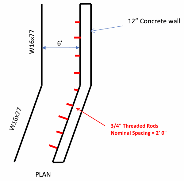

I need to check the capacity of an L3xL3x1/4” angle supported by (3/4”) diameter bolts embedded 3-3/4” into a concrete wall spaced 24” on center to support the edge of slab of a parking deck. The bolts are epoxied with HILTI RE 500 v3 epoxy. The angle is supporting 6’ tributary width of slab. Loads I need to account for are 4.25” concrete on 2” metal deck + 25 PSF SDL + 40 PSF LL.
I’m very new to steel design and don’t have experience with design of angles or connections. Some things I think I need to account for are: flexure of the angle, yielding of the bolt hole, shear of the bolt, pull out from the concrete. The issue is I have never checked any of these things before and would really appreciate it if someone would be able to walk me through the steps or point me to references for checking these things.

Hi all, thank you very much for the responses. Just to clarify, this is an existing structure that I am checking based on field measurements and contract documents. I have attached photos (section and plan) showing the configuration. If anyone could help me verify if I am on the right track in terms of the limit states I nee to check, suggest any additional limit states, and provide guidance on how to check the limit states I would really appreciate it.
 https://files.engineering.com/getfile.aspx?folder=d2b0bb88-3d2a-4217-be57-5539c26cbe0e&file=Screen_Shot_2018-10-04_at_9.55.59_PM.png
Just to clarify based on the above questions: Yes I am checking for bolts and not threaded rods. SDL is superimposed dead load (25 PSF) the other applied loads are 4.25" on 2" metal deck = 6.25" concrete... (150 PCF*6.25"/12 = 78 PSF)+40 PSF DL. Total DL = 103 psf... total LL = 40 PSF. I have not checked for impact loading before. This is a parking garage, would you need to check for impact loading?

Is the steel deck in your sketch drawn correctly? If so, it is spanning parallel with your steel angle, so your angle will see very little load.
Another load to consider - the angle might be transferring lateral loads (diaphragm to shear wall) as well.
Thank you SlideRuleEra - to install the "bolts" the contractor drilled an over-sized hole in the concrete wall, cleaned the holes, injected the Hilti epoxy and then installed the "bolt" into the wall. I was mistaken when I said "bolt". It is acually a 3/4" diameter threaded rod. The angle was fastened to the rod using a steel washer and hexagonal nut. I am happy to do the calculations myself... your guidance would be much appreciated.
Per the other question from CanPro... The steel deck is actually spanning the direction I indicated. Thanks, I didn't think about the lateral loads. We are using steel braced frames and there is a brace very close to this wall so I would think that would take most of the lateral loads.
Is that "brace" actually a long span joist (truss)? Does it deflect even slightly under loads?

Thanks for the questions, its teaching me to be more specific and detail oriented. SlideRuleEra I do have the allowable shear and tension values for the 3/4" threaded rods embedded in the concrete from my Hilti catalog. oldestguy the brace is a wide flange rolled section.
jseng9 - Good. I assume the threaded rods are installed per this marked up sketch. Is so, do two things:
1) Get confirmation from the field on bolt spacing. When installing epoxy anchors it is common for the drill to hit existing rebar and the hole has to be relocated. If there are spacing variations (in the field), determine maximum bolt spacing.
2) Determine the tributary loading area of the slab for one bolt, with maximum bolt spacing. Either sketch it or tell us (in detail) what it is (to verify that you have it right). When selecting maximum bolt spacing, consider how the last bolts are installed at the ends of the angle(s)... this could be the worst case.
[idea]
[r2d2]
To expand a bit on SRE's point #2 above - look for splices in the angle. If the last anchor in a run of angle is located too far from the splice, you get the angle effectively cantilevering past the last anchor, which will increase your effective tributary area.
Also, if you can, maybe post a more complete plan view of what is going on. As I mentioned above, and you confirmed, the deck is spanning parallel with the steel angle, so the tributary width of the angle is not 1/2*6'.
