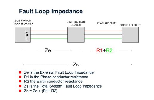

Hi Mbrooke. I was wondering how they addressed protected against the available fault current when a 220/380 system is fed from a large transformer.

Typically they rely on the impedance of the conductor itself going to the OCPD in question. For example, while in many parts of the world a 250kva pole pig or even 800kva+ ground mount transformer may feed hundreds of homes with a dozen businesses mixed in- the overhead LV run and service drop usually drops the short circuit current down to an acceptable level ie 6ka.
Further, most loop impedance testers are capable of giving a Ze along with a perspective fault current value. Once these values are known you can select your main OCPD.
For OCPD devices downstream, you take your listed conductor impedance, multiply by the length to get your R1+R2 and then add that to your ZE to get you ZS or max fault current that will be seen on the downstream OCPD.
The AC impedances for various common wiring methods will be listed in the back of BS7671.
The goal is 1) to select an OCPD that can interrupt the maximum anticipated fault current. 2) Make sure the short circuit current is high enough to meet the code listed disconnection time requirements for the circuit.
Thanks gang. A quick calc shows the SC current to the supply side of the 10kA branch circuit breakers to be less than 10 kA, despite the bus duct feeds. All the large motors (all HVAC) are fed through VFDs so there is no motor SC contribution. This entire project has been a cultural learning experience for me as the engineers performing the work are Chinese, and the way they handle interface with the Chinese AHJs is not at all like how we do here - where higher rank is given to older members and "losing face" is dreaded. In any case, compliance to short-circuit concerns appear OK. Thanks again!
