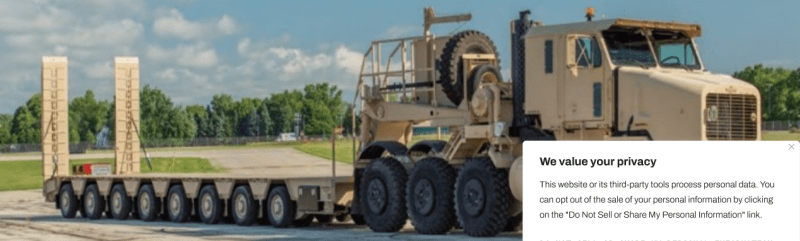

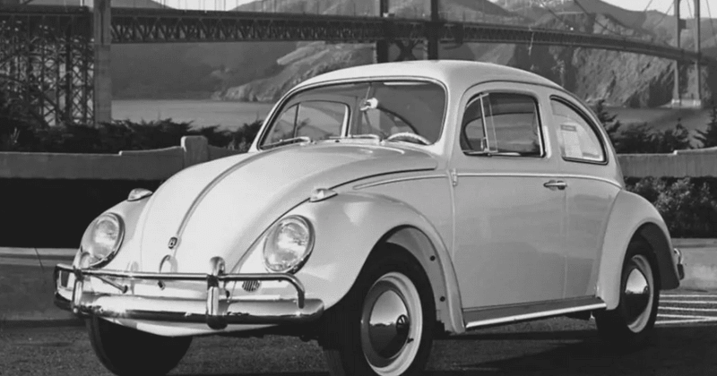

Maybe an illustration will help visualize my point.
I had a 300kg item that I regularly moved between locations.
The manufacturer of my vehicle listed the luggage capacity as 250 kg.
so I traded this:
for this
It may be a little overkill, but it gets the job done.
