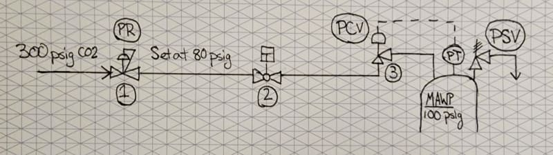

I now see what you mean. You need to look at single failure. So is the worst a regulator going full open and more flow going through the secondary Pressure control valve? or more likely the worst case is the PCV fails in whatever cause and goes full open and the regulator also goes full open trying to provide pressure which has fallen as the PCV has increased flow? However the pressure you calculate the max flow through your PCV could easily be the normal set pressure of the regulator assuming the regulator max flow is > max flow of the PCV.
So chose the max capacity of your regulator carefully. The max capacity of any gas blanket type system is related to max inflow due to liquid level falling or vapour contents suddenly cooling, e.g. in a cold rain shower. V small negative pressures and your tank collapses.

Thank you all for your responses. To LittleInch's point, I should have done this earlier, but a simple diagram of my gas feed to the tank is below.
Device (1) is a direct-acting, manually tuned pressure regulator which is set below the MAWP of the tank. This device is sized to allow pressurization of the tank in a specific time period.
Device (2) is an on/off, normally-closed ball valve that opens when pressurization of the tank is required.
Device (3) is a rising-stem control valve that modulates via an I/P converter to control the pressurization rate of the tank.
As I currently see it, devices (2) and (3) failing are irrelevant due to the regulated pressure downstream of device (1) being lower than the MAWP of the tank.
In the case of device (1) failing, I am still unsure whether device (3) must be considered to be in the fully open position. That seems to me to be a multiple-failure scenario. The controllers that would open the path of the high pressure gas to the tank would then have to fail immediately and completely in order for device (3) to be fully opened. I am still unsure how the idea of not accounting for controls as safety devices integrates into this scenario, and what conditions must be assumed.
A drawing really helps!
A couple of things.
Nomenclature - For me this isn't a tank, it's a Pressure vessel if you're above 15psi and hence other factors, laws and codes of practice start to apply.
Probably not helpful, but can't really see why you can't just get rid of 1 and make 3 a device able to regulate down from 300 psig. Then your failure mode is simply max opening , but then limit the CV or limit the opening mechanically. The you could turn item 2 into some sort of safety trip valve (FC?)
Some of this depend son what the failure mode is of item 3, but with two regulators / control valves in series it does get a bit complex. But if 3 is able to withstand 300 psi without breaking or being over pressured, what is 1 doing for you? If 3 can't handle the overpressure then it shouldn't be there...
