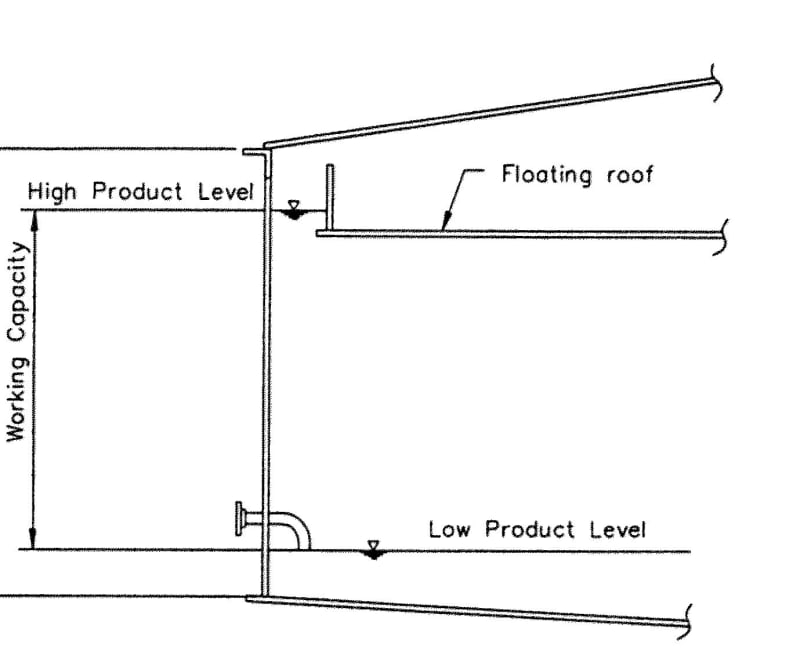

Cone down bottoms typically preferred for refined products which are lighter than water (in this case diesel ). They have some advantages such as;
- the tank can be drained completely, so better for the tanks with frequent product changes .
- the contact with water minimized..

out of ignorance, by cone up or down, do you refer to the bottom being slightly concave? or convex? inquisitive mimes want to know. Thanks...
Yes ..but the terms convex and concave are used for curved lines or surface. In this case the bottom plate is in the form of cone.
The following picture shows the cone down concept..
