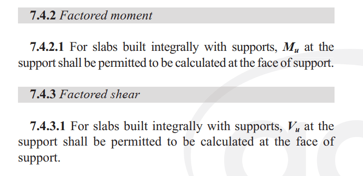

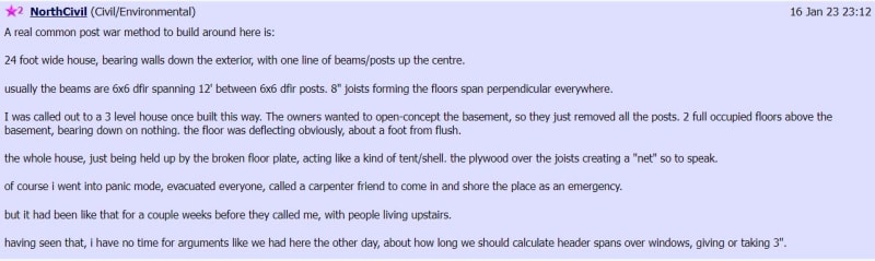

See snip from a thread a while back. For the record, I take it face to face of supports for one-way slabs like this.

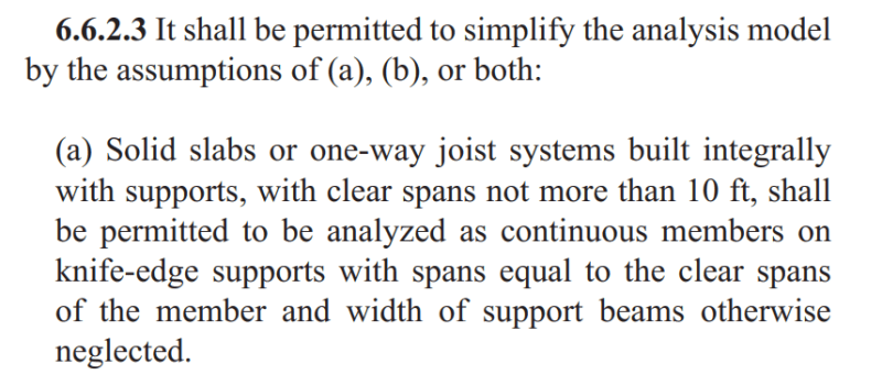

A few snippets from ACI:
The key here, is determining whether your slab is built integrally with supports.
If your slab is slightly overstressed from c/c span, I wouldn't sweat it.
