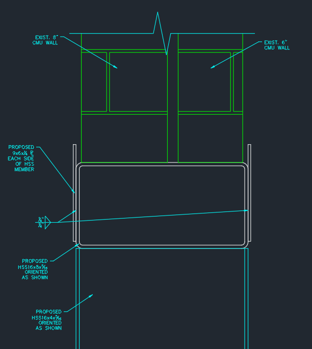

I have a client that is wanting to open up a CMU wall for as long of a span as I'll allow. Typically, I would just use angles for a lintel for the opening, but this wall is a combination of one 8" block wall and a 6" block wall, leading to an overall wall thickness of 14-15". I know I can find W shapes with this flange width, but I have major reservations against using the flange to support a wall instead of aligning with the web due to flange buckling and torsion. I have thought to add a plate to the outside faces of the steel to essentially make a steel section resembling a hollow CMU block.
Has anyone done design for eccentric loading on a W-shape or know of a design guide for it?

IlliniPE, adding the plates as you proposed doesn't preclude bend of the flanges of the beam (although it does engage the bottom flange, as well as the top, if you weld it to both). It's also alot of steel, which would make the bending capacity huge - the span would probably be limited the support available for the concentrated vertical loads at the ends of the span. Welding the bottom flange to the plates is not an easy weld, either.
I suggest a pair of angles, welded to the top flange of a WF, similar to what haynewp suggested. With and adequate weld, it makes for a very stable and strong built-up section. You may still need to add some vertical stiffeners transverse to the web to support the top flange at intermediate locations, depending on the load, span, and the size of angles you use.

This is a great point to consider. I had the thought of making the plates intermediate to allow for easier fabrication, but I agree that some angles on a W shape or HSS member would be easier. My primary concern that I will have to check is rotation/torsion with this configuration. That was the goal of the plates, to reduce rotation and aid in reducing flange bending.
As driftLimiter pointed out, if the beam is centered under wall there should be no torsion on the beam. With angles, or some other means of bracing the top flange to the wall above, LTB is prevented, so the beam should be stable.
If flange bending is a concern, transverse stiffeners are the more efficient and economical solution, if you even need them. Have you checked the flange thickness required for the load from the masonry? I suspect you'll find you don't need that much. If you do, you may want to consider an S shape.

It won't be centered under the load. See my response to jerseyshore. I believe I can attain the required strength with angles and a Wshape. Just need to ensure no rotation about the web. Two beams may be the way to go.
A significant difference in loading means I would probably lean to using two separate pieces as well. It's almost always easier to get 2 beams off the shelf then it is to do a lot of welding for a built-up section.

I think we are set on an HSS beam and HSS columns. My question is the connection. I cannot find any details of a bearing connection between an HSS beam and column. All of the details and design guides fix angles to the outside face of the column, and the beam bears on those angles. Are there any real concerns with allowing the beam to bear directly on top of the column? See attached image.
