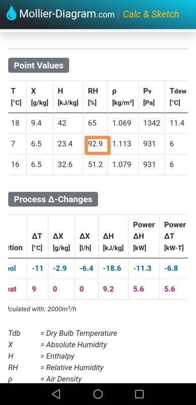

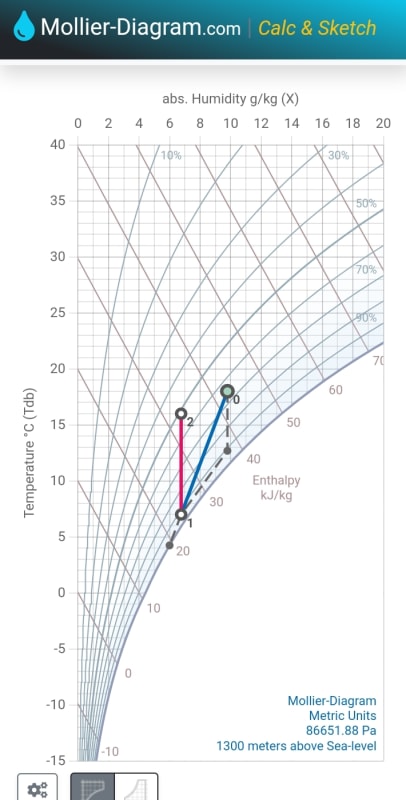

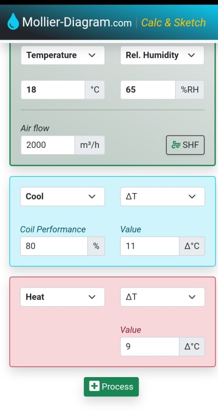

I have used online psychrometric calculator
And it gave me the following results:
So could you please let me know if dehumidification is done although RH after cooling coil is not exactly 100%?
Is the coil power correct to coumt on it?
Please correct me if i am wrong.
I don't understand what that data is. It looks strange with the temperatures set as a Delta T
As it say 18C @ 65RH has a dew point of 11.4 C. Looks correct.
But a delta T of only 4C may not be enough to actually get water to drop out before it heats up and basically exits the coils at close to 100% RH. When you heat it to get back to your inlet temp, the RH decreases.
Entering numbers in an online calculator doesn't necessarily explain why things happen. That calculator basically just shows you a single point of the huge 2D psychrometric chart. .... Reviewing and understanding the psychrometric chart will help you understand what is happening.

The entering air : 18 'c. 65% RH
Air flow: 2000 m3/h
The coil should cool it up to 7 'c and the the heating coil increase the temperature to 16 'c
The desired output air from the heating coil is 16 'c. 50% RH
My purpose from the dara is to know if dehumidification can be done and also kw of the cooling coil is correct.
If it is not correct please let me know what changes should be made and what is the problem in the online calculator.
Needless to say, the water temperature to cooling coil is 7'c

If the cooling coil inlet water temperature is 7 C and you want to bring air temperature to 7 C then you either need surface area approaching infinity or contact time approaching infinity or some combination. Back up and restate more achievable objectives.
Why can't you get the inlet water temp lower?
as BrianPetersen said, you need colder water. your diagram looks like is was based on 4 deg water.
Your problem is the coil has a heat exchanger efficiency of less than 100% (there also is the NTU method etc.). There are 3 resistances to heat transfer: the convection from air to the metal, the conduction through metal (fins, tube, and the fin-tube interface) and then the convection to the water. If all 3 resistances would be zero, all would be better. But alas, we live in the real world..... to make up for the real World and you need colder water.
Since the convection resistances also depend on flow velocity (turbulence etc.) and the build of the fins (dimpled etc.) the flowrate will change that. You likely don't have that detail and your 80% efficiency is just a guess. Could be 70%, or 60%. Then you need even colder water.

Something that i want to enlighten for myself by giving the numbers is that
I was told for dehumidificatiin the RH% AFTER cooling coil should be 100% but as you can see in the numbers given by the calculator the RH% is about 93% but the temperature is lowee than dewpoint of air!
Please clarify it for me by your knowledge and experience.
